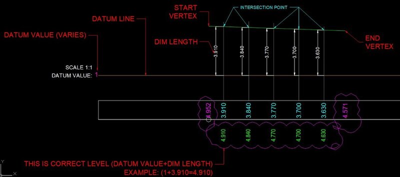

I have a ployline with dautm text value and datum line , I want text label of pline start vertex, intersection pont  and end vertex, based on datum.
If any have plz share need only y value, elevation, level of pline .
Thanks
See attached cad file
Thanks
POLYLINE Y VALUE.dwg

Thanks for your help sir,  one issue I notice, if I change the datum value and keep datum line same ,value of intersection point not coming accurate, only start vertex and and vertex is accurate. Note Same section but change datum value.
@Ish, if you don't mind, can you please attach video, gif, picture, etc. of the problem which you issued, because I'm not sure to fully understand the problem. Thanks
  • Agree 1
Sir, just I change date value 0 to 1, because dautm value and line is always varies.
Program working perfectly for zero 0 datum value and line, if dautm value and line change, not getting accurate level , this attachment. Thanks
DATUM VALUE CHANGE.dwg

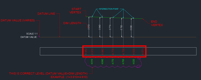

@Ish, I modified the code from the fist post, just copy it again and try it.
Now, you will get the desired elevation values (picture 1, the red rectangle).
Best regards.

hi This is a very good lisp, can this be still upgraded to show the station of the selected lines also, at a certain distance south. like 20 or something.
Hi @symoin
If you can provide the an example file with explanations inside of what you want, I can try it to modified the code for your purposes.
Best regards.
9 hours ago, Saxlle said:
Hi @symoin
Best regards.
Here, I have the profile generated from Civil 3D. The elevations and stations are generated at every 25m interval (white lines), but the crossings are not included. So if I get a lisp that will generate the staion and elevations for the crossings (pink lines) same as the details for the white lines. with your Yval we can get the elevations but need the stations also.
Trying to add the purple line values will introduce a new problem of overlapping text. trying to remember with CIV3D add extra pts in a long section in particular, one way is add that chainage as part of the alignment.
Using say Civil Site Design it has this add extra chainages feature built in. Runs in Civ3D. You can do a mini range start-end chainge, spacing and so on.
Can you provide the an example drawing? I'm not familiar with working in Civil 3D.
  • SLW210 changed the title to Lisp for to get y value of polyline based on datum value and line.
Here is the profile sample
PROFILE-SAMPLE.dwg
@symoin
Can you please explain the logic of getting an elevation from "Profile-sample.dwg"? It is kind different from the picture which were you posted above. If I am not getting wrong, from picture below, the elevation need to looks like this (so, the equidistant need to be equal?):
Best regards.
If your trying to get the levels shown by the Brown lines color 11 you will end up with a mess of overlapping text. In this image looks like a road etc so want levels.
Civ3D at times lacks some functionality, it looks like you have used a built in grid option for plotting long section etc. You may be better off going back to your CAD dealer and ask for help about how to set up CIV3D to meet your needs. I know in other add on software can use different methods  to set what points get levels plotted, A lot of times the complexity of using CIV3D is a problem and finding the solution is difficult.
Maybe post this question into the CIV3D forum. I stopped using CIV3D many years ago so can not help.
Definitely, there will be bunch of overlapping texts. But, I think the problem is in the "grid", the equidistants are not equal and elevations can't be obtained.
As I mentioned: I'm not familiar with working in Civil 3D, so I can't help here further.
