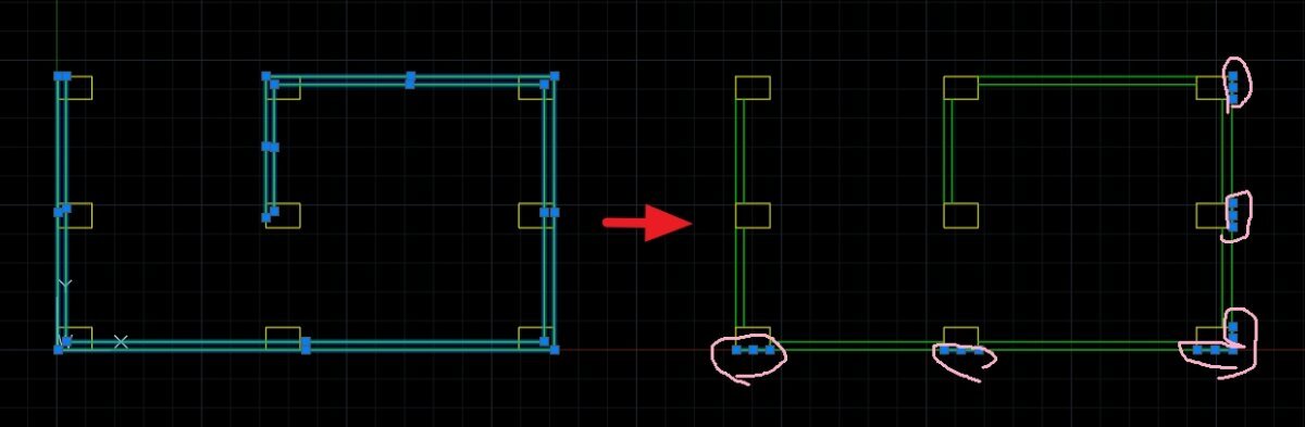

I need a LISP routine.
Command name: CCW (Column Cut Wall)
The workflow is: first select the yellow layer (columns), then select the green layer (walls).
The routine should trim all wall lines that are inside the closed polylines on the column layer, including cutting and removing any wall lines that overlap with the column boundaries.

I give it a try.
this is what I got.This routine goes wrong with overlapping. and change the layer(green to yellow)
lisp request_tics result.dwg
I wish the result could be keeping green lines in the original layer, and remove the overlaping
The LISP worked on your original drawing, after I flattened it. You have issues with that drawing.
You need to set the Current Layer to the one you want.
I follow your instructtion. and do the other test, flattened it befor running TICS  ,make sure they are flat. but there are still some overlaping lines left .

On 10/31/2025 at 2:51 AM, SLW210 said:
Use OVERKILL to remove the overlaps.
Thanks you...!
