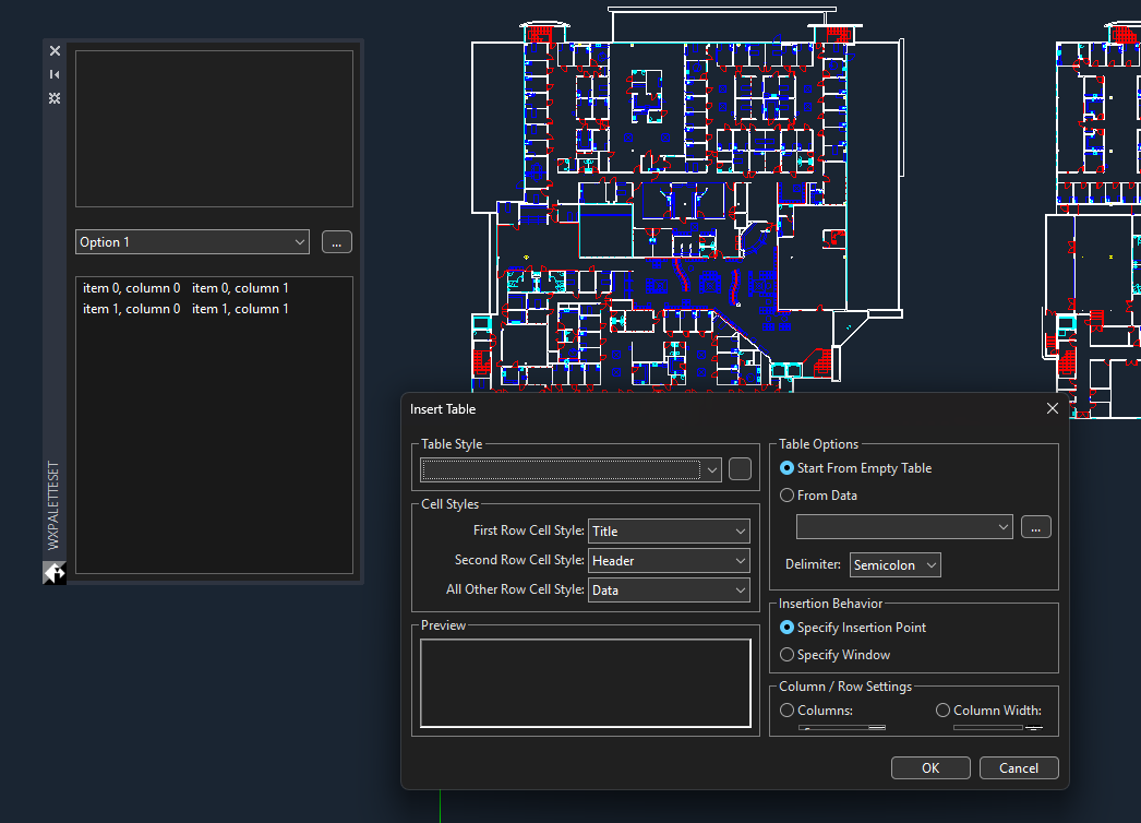

Danielm103 Posted December 1, 2025 Author Posted December 1, 2025 (edited) This is a test with wxArx, github.com/CEXT-Dan/WxArx Has a great looking palette, wxDialogs work fine. Edited December 1, 2025 by Danielm103 1 Quote
