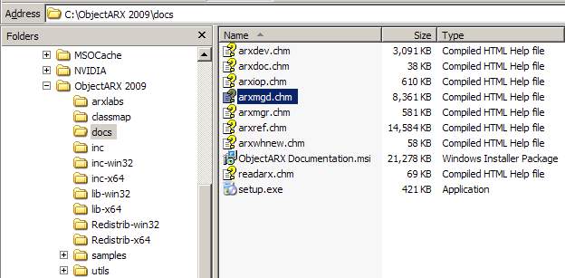

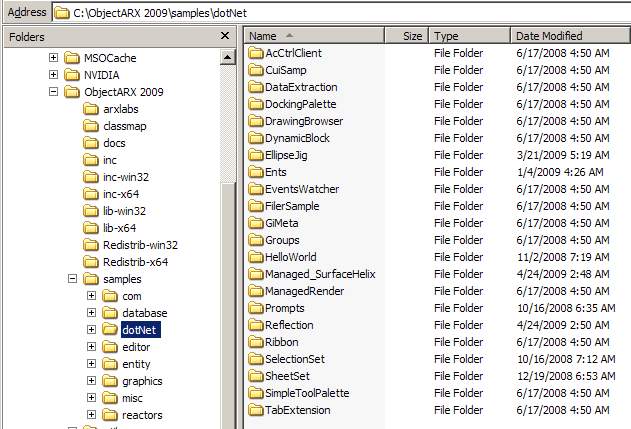

The ObjectARX SDK does include documentation and samples for C# and VB.NET development (Managed ARX). See attached.
