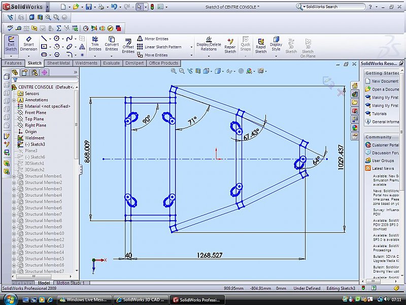

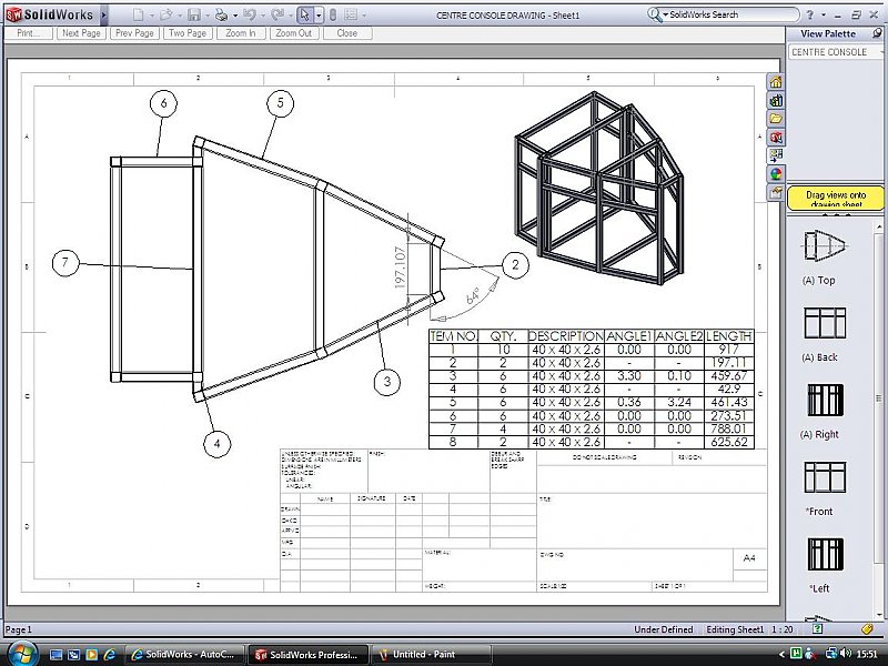

ramsay Posted April 25, 2009 Posted April 25, 2009 I have drew up a 40 x 40 x2 box section framework. The problem i have is the weldments cutlist i cant get the cut angles of item no 2 in the cutlist it just comes up blank. I take it this must be a problem with my sketch. Has anyone here any weldments experience. Does anyone know how to fix this / Thanks in advance Quote
shift1313 Posted April 25, 2009 Posted April 25, 2009 how was link #2 drawn? are the ends angled like they are supposed to be? Quote

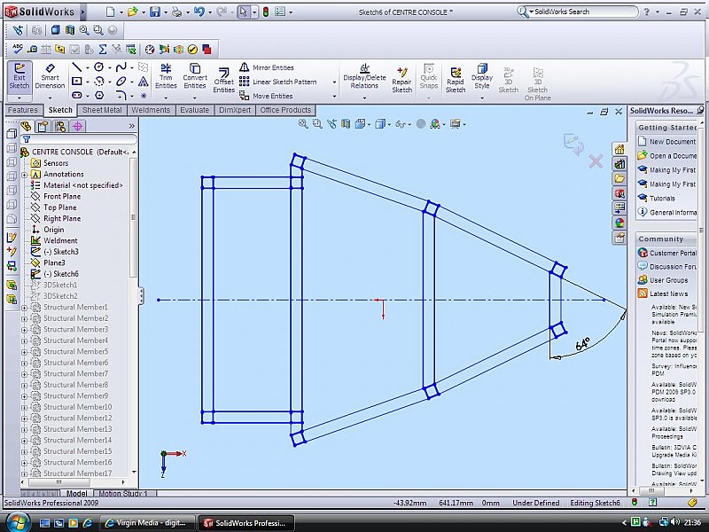

ramsay Posted April 25, 2009 Author Posted April 25, 2009 Here is the sketch i used to create the model Quote
ramsay Posted April 28, 2009 Author Posted April 28, 2009 Here is the sketch i used to create the model Quote
shift1313 Posted April 28, 2009 Posted April 28, 2009 thats odd, im not really sure what is going on with it ramsay. what number on your list is the bar in the center of your model. it looks like its not included in the chart Quote
ramsay Posted April 28, 2009 Author Posted April 28, 2009 Its no 8 shift the uprights are no 1 Iam new to solidworks trying to teach myself ive got tutorial dvds and iam following them but i cant get the angle to appear on the cut list for some reason its happening with 2 other frames iam drawing up i must be doing something wrong but i cant figure out whats wrong the cut list gives me the longest point 2 point size but no angle ? thanks for the reply Quote
shift1313 Posted April 28, 2009 Posted April 28, 2009 so is your weldment cutlist setup up for automatic or manual? can you right click on one of the tubes not included and see if you have the option Make Non Weld Bead. Quote
ramsay Posted April 28, 2009 Author Posted April 28, 2009 Weldment cutlist is on automatic i have tryed updating cutist still same happens. I have tryed selecting make non weld bead but the same happens shift Do you know anyone on here thats experienced with weldments. Quote
