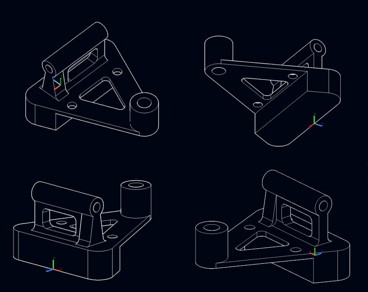

As Kencaz mentioned previously, create a 3D model and then you can view it from any angle and you won't have to spend a lot of time and effort trying to figure out fillets and whatnot.
I created this model in about 20 minutes. Obviously I don't know any of the dimensions so I had to just guess, but now that I have the model I can spin it around and view it from all angles. Unless you're using Autocad LT and don't have access to the 3D modeling tools, there's no need to fool around with isometric drawing. Just my opinion. ;)

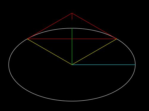

Here's some food for thought when thinking about isometric ellipses. You may not want to use this approach as it is labor intensive but I offer it as potential solution.
An isometric ellipse has three axes that are of interest (see image below).
Major radius (cyan line)
Minor radius (green line)
Conjugate axis radius (yellow lines)
The magnitude of the conjugate axis is the effective radius of the circle that is being viewed at an isometric orientation.
For circles that lie on principal planes of an isometric drawing the ratio of the conjugate axis to the minor or major radius is a fixed value as follows:
minor radius / conjugate axis = sqrt(2)/2
major radius / conjugate axis = sqrt(3/2)
Therefore to create an isometric ellipse that has a conjugate axis of 5 we have:
minor radius = sqrt(2)/2 * 5 = 3.5355
major radius = sqrt(3/2) * 5 = 6.1237
Creating an ellipse with these values for the minor and major radii will yield the desire fillet arc of 5.
