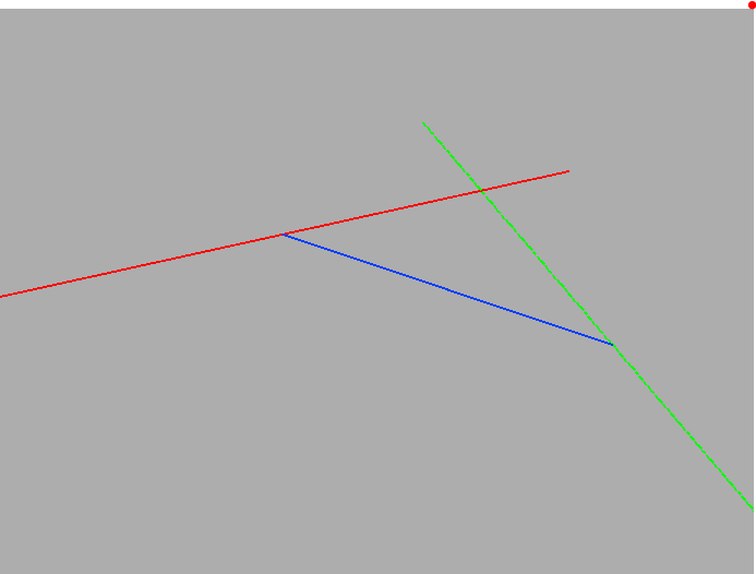

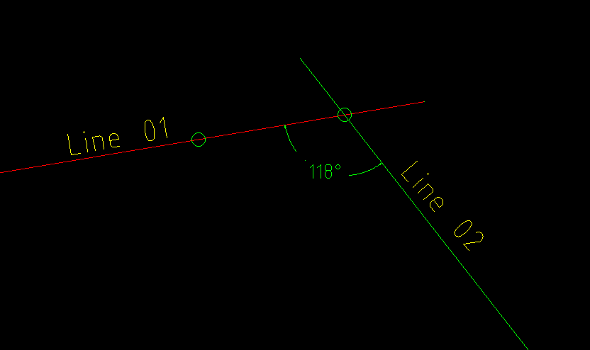

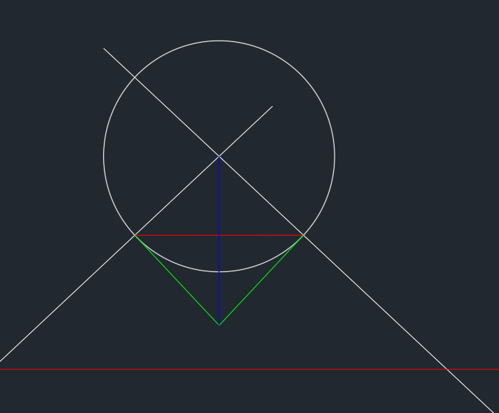

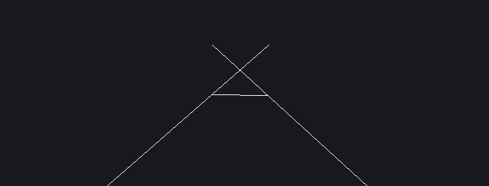

Sheep Posted August 5, 2020 Share Posted August 5, 2020 Hello to all. Hope everyone feeling great. Can someone help me with this. I want to make a line from Line 01 to Line 02. The length of the line base on user input. The mid of the new line must parallel with the intersection of Line 01 and Line 02. Let say the line is 10 and i just pick Line 01 and Line 02 and LISP will create a line within Line 01 and Line 02. I hope you guys can understand. Thank you for your time. Quote Link to comment Share on other sites More sharing options...
eldon Posted August 5, 2020 Share Posted August 5, 2020 Perhaps you mean like Chamfer with No Trim? Quote Link to comment Share on other sites More sharing options...
Lee Mac Posted August 5, 2020 Share Posted August 5, 2020 @Sheep Which line in your image is the end result? Quote Link to comment Share on other sites More sharing options...

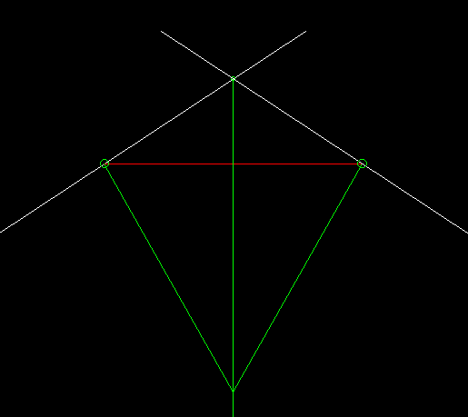

Sheep Posted August 6, 2020 Author Share Posted August 6, 2020 (edited) 9 hours ago, Lee Mac said: @Sheep Which line in your image is the end result? Thanks for your reply @Lee Mac. Below is the end result that i'm looking for. Maybe i should rephrase my question. The lines mid (red) don't have to be parallel OR parallel to the intersection (the top circle) as long as the line fits between both side lines. For example the line is 10m and both end of that line must connect to the side lines. Tried making rectangle but the problem is i have to place it manually. I have almost 120 rectangles (and they are different length) to make and that is taking so much time. My LISP is at the most basic level, so VLisp is too hard for me to understand. Can you please guide me in autolisp? Thank you for your time. Edited August 6, 2020 by Sheep Quote Link to comment Share on other sites More sharing options...

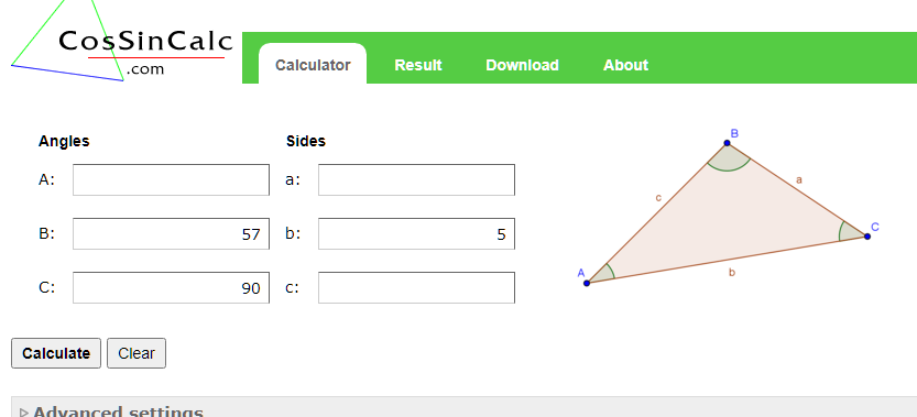

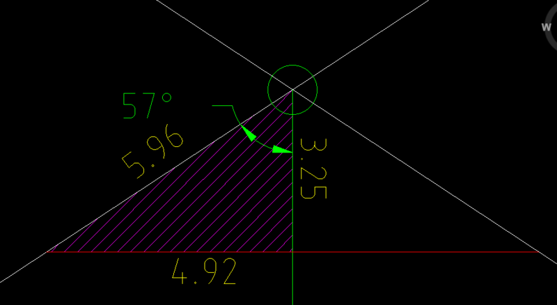

Sheep Posted August 6, 2020 Author Share Posted August 6, 2020 (edited) By breaking things down, i used only the left side to make a triagle. By using the calculation from CosSinCalc, that is as close i can get ( still OK). Now, how do i get the angle? Do i have to DIMANG all the time? Edited August 6, 2020 by Sheep Quote Link to comment Share on other sites More sharing options...
BIGAL Posted August 6, 2020 Share Posted August 6, 2020 Is it not this red line is the intersect with circle points. Quote Link to comment Share on other sites More sharing options...
Sheep Posted August 6, 2020 Author Share Posted August 6, 2020 What about the length of the red line? Let say 10m, how can i make it 10m by using a circle? Quote Link to comment Share on other sites More sharing options...
eldon Posted August 6, 2020 Share Posted August 6, 2020 (edited) 5 hours ago, Sheep said: Will the line (with different length) fits between the side line? That is what Chamfer does. You would have to put in the correct distance from the intersection point. Edited August 6, 2020 by eldon Quote Link to comment Share on other sites More sharing options...
Sheep Posted August 6, 2020 Author Share Posted August 6, 2020 (edited) 27 minutes ago, eldon said: That is what Chamfer does. You would have to put in the correct distance from the intersection point. Thank you for the reply. The problem is, no distance was supply from the intersection. Just the length of the line (10m). How about FILLET--NO TRIM--RADIUS? Will it work? If yes, how do i write the code? I might can work out the rest if i use the radius to get the point on both side lines. (command "FILLET" Line_1 "R" Radius_Curve "" "TRIM" "N" Line_2 "") Edited August 6, 2020 by Sheep Quote Link to comment Share on other sites More sharing options...

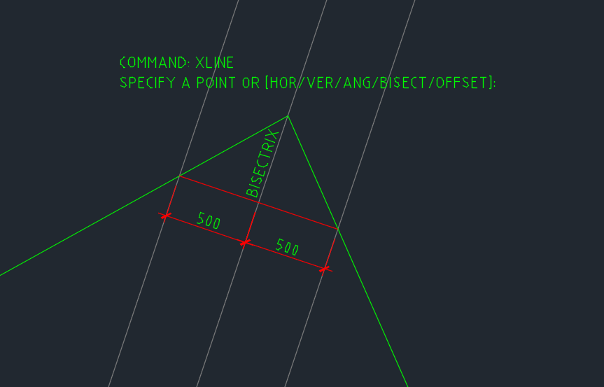

guran Posted August 6, 2020 Share Posted August 6, 2020 You draw a "XLINE / Bisect" through the intersection and offset the 0:5m in both directions. 1 Quote Link to comment Share on other sites More sharing options...
Sheep Posted August 6, 2020 Author Share Posted August 6, 2020 6 minutes ago, guran said: You draw a "XLINE / Bisect" through the intersection and offset the 0:5m in both directions. Sorry, not following you. Can you please give an example please. Quote Link to comment Share on other sites More sharing options...
guran Posted August 6, 2020 Share Posted August 6, 2020 1 Quote Link to comment Share on other sites More sharing options...

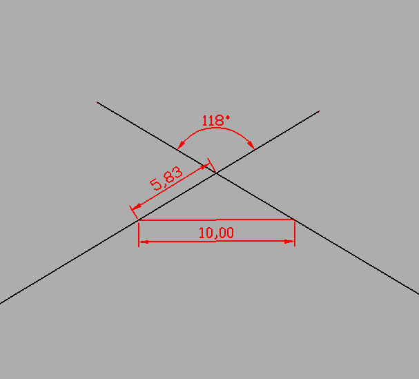

BIGAL Posted August 7, 2020 Share Posted August 7, 2020 (edited) Sin= 0/H Cos = A/H tan= O/A Others have a habit of answering. Of the top of my head 1/cos (90-118/2) * (dist / 2) = 5.83 So can work out point after using ang1 ang2 intersectwith for intersection point. Then polar 5.8331669860910269322409769334776 along in correct direction. If you use a circle and intersectwith will have problems. Edited August 7, 2020 by BIGAL Quote Link to comment Share on other sites More sharing options...
