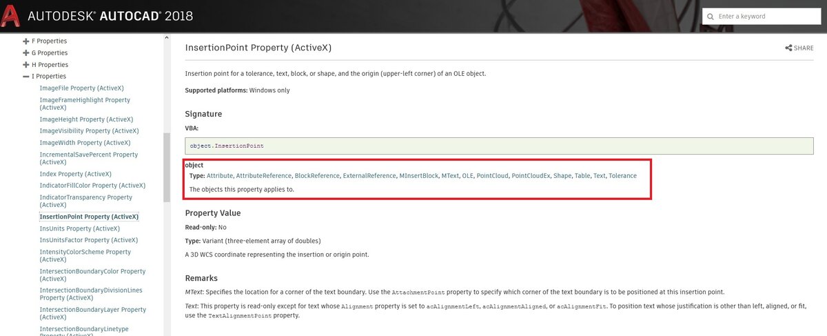

rlx Posted April 11, 2021 Share Posted April 11, 2021 (edited) inspoint prop accoording to active-x reference Edited April 11, 2021 by rlx Quote Link to comment Share on other sites More sharing options...
itacad Posted April 11, 2021 Author Share Posted April 11, 2021 Hello and thanks in the meantime. By insertion point I meant what is considered such by the object snap. For example, texts have an insertion point...for other types of objects (lines, polygons, etc.) I don't need them. Greetings Quote Link to comment Share on other sites More sharing options...
