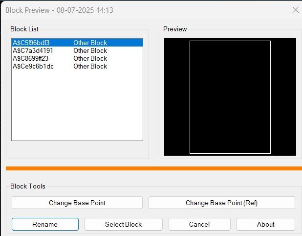

I didn't know you could do that! Still need to add the tabs \t to the base list, but you'd get a better result I think

Use the DCL tabs attribute and prefix the list items with a tab character ("\t").
I tried that also it doesn't give any difference @Steven P

One way, might be the easiest is to change the list that populates 'Block List', adding spaces to the nested block So you might have a line like this in your LISP: (start_list "lst" 3)(mapcar 'add_list BlockList)(end_list) Where BlockList is your list of block, might be (setq BlockList (list "BLOCK-1" "BLK-1" "BLK-2"... "BLOCK-2")) Which you could change to be (setq BlockList (list "BLOCK-1" " BLK-1" " BLK-2"... "BLOCK-2")) I don't think you can do the indenting with DCL, has to be done before then.

Hi Sir, how to gap betwwen main block and nested block in dcl ;----------------------------------------------- (cond ((null (setq lst (vl-sort lst '<))) (princ "\nNo blocks found in drawing.") ) ((null (and (setq tmp (vl-filename-mktemp nil nil ".dcl")) (setq des (open tmp "w")) (foreach line (list (strcat "blockpreview : dialog { label = \"" datetitle "\";") ;; Title with date-time " spacer;" " : row {" " : boxed_column { label = \"Block List\"; width = 35; fixed_width = true;" " : list_box { key = \"lst\"; height = 15; fixed_height = true; }" " }" " spacer;" " : boxed_column { label = \"Preview\"; width = 35; fixed_width = true;" " : image { key = \"img\"; height = 15; fixed_height = true; }" " }" " }" " spacer;" " : image { color = 30; width = 50; height = 0.5; alignment = centered; }" ;; Orange line " spacer;" " : boxed_column { label = \"Block Tools\";" ;; Single box around ALL buttons " : row {" " : button { key = \"cbp_btn\"; label = \"Change Base Point\"; }" " : button { key = \"cbpr_btn\"; label = \"Change Base Point (Ref)\"; }" " }" " spacer;" " : row {" " : button { key = \"rename_btn\"; label = \"Rename\"; is_default = true; }" " : button { key = \"select_btn\"; label = \"Select Block\"; }" " : button { key = \"cancel\"; label = \"Cancel\"; is_cancel = true; }" " : button { key = \"about\"; label = \"About\"; }" " }" " }" " spacer;" " : text { label = \"Author: XYZ | https://abcd.com/\"; alignment = centered; }" "}" ) (write-line line des) ) (not (setq des (close des))) (< 0 (setq dcl (load_dialog tmp))) (new_dialog "blockpreview" dcl) ) ) (princ "\nUnable to load dialog.") ) ;------------------------------------------------
