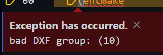

Forward Visibility Lisp - DXF issue
Steven P replied to CivilTechSource's topic in AutoLISP, Visual LISP & DCL
Sounds like on the last run through the while loop SPoint is having an error... if you look at (setq SPoint (vlax-curve-getPointAtDist SelPline (+ Counter inc))) - do you need this line since at the start of the next loop you are setting SPoint again and before it is used. -

Hi I found this Forward Visibility Lips online but it was drawing the forward vis line slightly wrong so I have modified it now. It works okay, but when I was debugging it at the end of the routine it would through an error message (See image). The lisp however does complete everything as required apart from setting Layer 0 at the end. I am looking to address that error. (vl-load-com) (defun C:CTS-ForwardVis () ;Set the Layer for the New Polylines (if (not (tblsearch "LAYER" "CTS-Forward Visibility")) (command "-LAYER" "_M" "CTS-Forward Visibility" "_C" "True" "255,100,0" "CTS-Forward Visibility" "" "")) (command "clayer" "" "CTS-Forward Visibility" "") ; Predefined variables (setq ForwardVisDistance 15.0) ; Default forward visibility distance (setq inc 2.0) ; Default increment/resolution ; Prompt user to accept/change defaults (initget "Yes No") (if (= (getkword (strcat "\nUse default settings? [Yes/No] <Yes>: ")) "No") (progn (setq ForwardVisDistance (getdist (strcat "\nEnter default visibility distance <" (rtos ForwardVisDistance 2 2) ">: "))) (setq inc (getdist (strcat "\nEnter default increment/resolution <" (rtos inc 2 2) ">: "))) ) ) (princ (strcat"\nSelect Polyline:")) (while (not (setq js (ssget "_+.:E:S" (list (cons 0 "*POLYLINE,ARC,SPLINE") (cons 67 (if (eq (getvar "CVPORT") 2) 0 1)) (cons 410 (if (eq (getvar "CVPORT") 2) "Model" (getvar "CTAB"))) (cons -4 "<NOT") (cons -4 "&") (cons 70 112) (cons -4 "NOT>") ) ) ) ) ) ;----- Assign the Selected Polyline to a VLA-Object and get its Length and other properties (setq SelPline (vlax-ename->vla-object (ssname js 0)) SelPline_Length (vlax-curve-getDistAtParam SelPline (vlax-curve-getEndParam SelPline)) Counter 0.0 SPoint nil EPoint nil ) ;----- Check Forward Visi Distance and Increment against the Length of the Selected Polyline (while (>= ForwardVisDistance SelPline_Length) (if (>= ForwardVisDistance SelPline_Length) (princ "\nDistance execeded length of Selected Polyline")) ) (while (>= inc SelPline_Length) (if (>= inc SelPline_Length) (princ "\nDistance execeded length of Selected Polyline")) ) ;----- Function to create Forward Visibility Polylines (while (< Counter SelPline_Length) (setq EPoint (vlax-curve-getPointAtDist SelPline (+ Counter ForwardVisDistance))) (setq SPoint (vlax-curve-getPointAtDist SelPline Counter)) (entmake (append '( (0 . "LWPOLYLINE") (100 . "AcDbEntity") (67 . 0) (410 . "Model") (8 . "CTS-Forward Visibility") (62 . 256) (6 . "ByLayer") (370 . -2) (100 . "AcDbPolyline") (90 . 2) ) (list (cons 10 SPoint)) (list (cons 10 EPoint)) '((210 0.0 0.0 1.0)) ) ) (setq SPoint (vlax-curve-getPointAtDist SelPline (+ Counter inc))) (setq Counter (+ Counter inc)) ) (command "clayer" "" "0" "") ) Thank you!!
