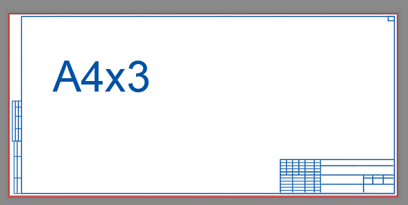

Add to the code the ability to create layouts for non-standard formats
Nikon replied to Nikon's topic in AutoLISP, Visual LISP & DCL
The layout is created correctly for this non-standard format. ((and (> Square 177755) (< Square 196466)) (vla-put-ConfigName Layout "DWG To PDF.pc3") (vla-put-CanonicalMediaName Layout "UserDefinedMetric (297.00 x 630.00мм)")) -
BIGAL replied to Nikon's topic in AutoLISP, Visual LISP & DCL
If you look at this snippet of code it is all the values required, insert correct title block and make a viewport. This is for one viewport, multiple title blocks. (cond ((= ntitle "A0_Landscape") (setq ht 780.0 wid 1160.0 xpt 878.0 xwid 62.0 yht 32.0)) ((= ntitle "A1_Landscape") (setq Ht 541.0 wid 831.0 xpt 542.0 xwid 62.0 yht 32.0)) ((= ntitle "A1_Portrait") (setq Ht 774.0 wid 571.0 xpt 229.0 xwid 62.0 yht 32.0)) ((= ntitle "A2_Landscape") (setq ht 367.0 wid 584.0 xpt 295.5 xwid 62.0 yht 32.0)) ((= ntitle "A2_Portrait") (setq ht 554.0 wid 410.0 xpt 209.5 xwid 41.0 yht 23.0)) ((= ntitle "A3_Landscape") (setq ht 247.0 wid 400.0 xpt 200.0 xwid 41.0 yht 23.0)) ) So for multiple viewport the cond would use a "list" of values, title block then the viewport say lower left X,Y then upper right X,Y, repeat for how many viewports required. You could pick correct title block from a dcl radio button you can have around 20 in vertical dcl. If I am understanding correct post a true title block with say 3 viewports and will post some sample code, -
Thank you, is it possible to write this in the code so that the layout parameters are obtained automatically. I didn't understand this line: ("A3" "0,20" "140,190" "140,20" ""280,190" -
Are you saying you want say a A3 sheet 420x297 but with 3 viewports, that can be done. To have a oversize sheet does not make sense to me. You just set up the sheet details and the location of each viewport, not hard to do. ("A3" "0,20" "140,190" "140,20" ""280,190" and so on) -
pkenewell replied to Nikon's topic in AutoLISP, Visual LISP & DCL
NOTE: If your viewport frames do not match the paper size (for example: you put your borders in Paperspace and you only use the area internal to the border), Then use the area of the viewport frame to determine the size range, not the paper size. -
It is enough that the frames are just on one layer. I will try to add squares and formats to the code, but it seems to me that a different approach is needed for non-standard formats. -
Are these the actual names of the Paper sizes in the pc3 file? The squares in your example file are just the paper sizes. You need to know the Frame layer, and the size range of the Frames that create your viewports. In any case - you should have all the information you need to do it yourself. as I said in the above to lay it out more clearly: 1) You need a range of AREA to be within on the frames. For example, on your "A4x3", (297 x 630) = 187110. Your range for the "square" variable should be a min and max with this value in the middle, such as 187110 - 10000 = 177110 "(> Square 177110)" and 187110 + 10000 = 197110 "(< Square 197110)" 2) each added condition should have the exact name of the Custom paper size: ((and (> Square 177110) (< Square 197110))(vla-put-ConfigName Layout "DWG To PDF.pc3")(vla-put-CanonicalMediaName Layout "_A4x3_(297.00_x_630.00_MM)")) ALSO: 3) You must have a unique Layer for the Frame polylines or blocks, something like "MyPaperSizeFrameLayer", or anything, as long as it is unique to the frames. -
I have attached a dwg example. -
The condition lines I added were just examples of how to add more sizes. As long as you know the areas and the name of the paper size, you should be able to add them. The "Square" variable as i understand it, is the min and max AREA of the frame you select (Length x Width), for the condition to select the paper size. This depends on what you are selecting for the frame to define the paper size. How would I know, if I don't have an example of what you are selecting? -
I don't use such formats: "ISO_full_bleed_2A0_(1189.00_x_1682.00_MM)" "ISO_full_bleed_4A0_(1682.00_x_2378.00_MM)" The sizes of the formats are listed in the list "List of non-standard formats". I don't understand how to get these numbers: (> Square 59251) (< Square 65488) (> Square 118503) (< Square 130977) and how will they help you create a non-standard layout? -
@Nikon While I don't know this routine, and don't recognize the Paper Sizes you have specified. The change would have to do with this section I think (see below). I added a couple condition lines for standard layouts "ISO full bleed 2A0" and "ISO full bleed 4A0" that are in my standard "DWG to PDF.PC3" file. I don't know what determines the area of the viewports though, (it seems that it is an object you select), so I am guessing at the area range of the viewport sizes. (cond ((and (> Square 59251) (< Square 65488)) (vla-put-ConfigName Layout "DWG To PDF.pc3") (vla-put-CanonicalMediaName Layout "ISO_full_bleed_A4_(297.00_x_210.00_MM)")) ((and (> Square 118503) (< Square 130977)) (vla-put-ConfigName Layout "DWG To PDF.pc3") (vla-put-CanonicalMediaName Layout "ISO_full_bleed_A3_(420.00_x_297.00_MM)")) ((and (> Square 237006) (< Square 261954)) (vla-put-ConfigName Layout "DWG To PDF.pc3") (vla-put-CanonicalMediaName Layout "ISO_full_bleed_A2_(594.00_x_420.00_MM)")) ((and (> Square 474012) (< Square 523908)) (vla-put-ConfigName Layout "DWG To PDF.pc3") (vla-put-CanonicalMediaName Layout "ISO_full_bleed_A1_(841.00_x_594.00_MM)")) ((and (> Square 948024) (< Square 1047816)) (vla-put-ConfigName Layout "DWG To PDF.pc3") (vla-put-CanonicalMediaName Layout "ISO_full_bleed_A0_(841.00_x_1189.00_MM)")) ((and (> Square 1949898) (< Square 2049898)) (vla-put-ConfigName Layout "DWG To PDF.pc3") (vla-put-CanonicalMediaName Layout "ISO_full_bleed_2A0_(1189.00_x_1682.00_MM)")) ((and (> Square 3949796) (< Square 4049796)) (vla-put-ConfigName Layout "DWG To PDF.pc3") (vla-put-CanonicalMediaName Layout "ISO_full_bleed_4A0_(1682.00_x_2378.00_MM)")) (T (vla-put-ConfigName Layout "None")) ; Default to No plotter for non-standard sizes ) -
