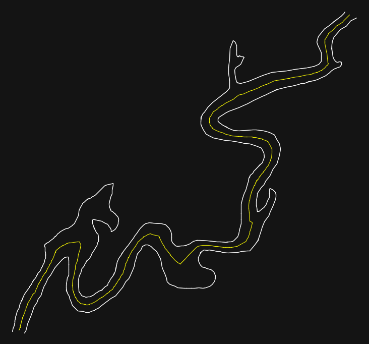

I'm interested in where this topic will be going with the different "side quests" like islands and inlets. In the mean time I kept going, trying to fix my version and after a lot of testing/debugging I changed to code again. Now it is working as expected on all of the examples I have found! ;| ; Calculate centerline between two polylines - dexus ; Function checks intersections of the offsets of two lines to create a middle/avarage line. ; https://www.cadtutor.net/forum/topic/98778-hybrid-parallel/page/7/#findComment-677877 ; Version / Date - Change ; 0.01 [19-11-2025] - Initial release ; 0.02 [27-11-2025] - Added corner support on negative side of crossing polylines ; 0.03 [28-11-2025] - Extra check using vertex to closest point as distance ; 0.04 [28-11-2025] - Added error function ; 0.05 [01-12-2025] - Improved distance check to prevent zigzag lines ; 0.06 [01-12-2025] - Check if offset can be used before adding points ; 0.07 [01-12-2025] - Improved side check on 3 points ; 0.08 [04-12-2025] - Don't compare startpoint to offset when eiter of the polylines is closed ; 0.09 [05-12-2025] - Add points for parallel end segments ; 0.10 [18-12-2025] - More checks for deleting lines and added dedicated function ; 0.11 [08-01-2026] - Support for multiple output lines of the offset function ; 0.12 [08-01-2026] - Bulges are transformed to lines to handle cocentric arcs ; 0.13 [08-01-2026] - Rewrote the _avarageAngle and _diffAngle function |; (defun c:cl (/ corners ent1 ent2 gap index loop maxlen offset offsetdistance org1 org2 parallel pts sides ss start te0 te1 te2 tmp1 tmp2 LM:ProjectPointToLine LM:intersections _addPoints _avarageAngle _checkOffset _checkSortDirection _copyPolyline _cornerOffset _deleteTmpLine _diffAngle _doOffset _getAnglesAtParam _polyline _side *error*) (defun *error* (st) (if (wcmatch (strcase st t) "*break,*cancel*,*exit*") (redraw) (princ (strcat "\nOops! Something went wrong: ") st) ) (mapcar '_deleteTmpLine (list ent1 ent2 te0 te1 te2)) (princ) ) ;| ; Deletes an object or list of objects ; @Param obj vla-object or list |; (defun _deleteTmpLine (obj) (cond ((null obj)) ((vl-catch-all-error-p obj)) ((= (type obj) 'list) (mapcar '_deleteTmpLine obj)) ((not (vlax-erased-p obj)) (vla-delete obj)) ) ) ;| ; Draw Polyline - dexus ; Draw a polyline from a list of points, but filter out colinear points ; @Param lst list of points ; @Returns ename of polyline |; (defun _polyline (lst closed / prev pts) (while lst (cond ( (and (cdr lst) prev (or (equal (cdr lst) prev 1e-8) ; Remove duplicate points (null (inters prev (car lst) prev (cadr lst))) ; Remove collineair points ) ) ) ((setq pts (cons (cons 10 (setq prev (car lst))) pts))) ) (setq lst (cdr lst)) ) (entmakex (append (list (cons 0 "LWPOLYLINE") (cons 100 "AcDbEntity") (cons 100 "AcDbPolyline") (cons 90 (length pts)) (cons 8 (getvar 'clayer)) (cons 70 (if closed 1 0)) ) (reverse pts) ) ) ) (defun _copyPolyline (ent maxlen closed rev / bul pts index curve steps size next) (setq ent (vlax-ename->vla-object ent) index 0) (repeat (1+ (fix (vlax-curve-getEndParam ent))) (cond ( (and (not (vl-catch-all-error-p (setq bul (vl-catch-all-apply 'vla-getbulge (list ent index))))) (not (equal bul 0.0 1e-8)) (setq next (vlax-curve-getDistAtParam ent (1+ index))) (not (zerop (setq steps (fix (* (/ (- next (vlax-curve-getDistAtParam ent index)) maxlen) 45))))) ) (setq size (/ 1.0 steps) curve index) (repeat steps (setq pts (cons (vlax-curve-getPointAtParam ent curve) pts) curve (+ curve size)) ) ) ((setq pts (cons (vlax-curve-getPointAtParam ent index) pts))) ) (setq index (1+ index)) ) (_polyline (if rev (reverse pts) pts) closed) ) (defun _side (pline pnt / cpt end target der) ; https://www.theswamp.org/index.php?topic=55685.msg610429#msg610429 (setq cpt (vlax-curve-getClosestPointTo pline pnt) end (vlax-curve-getEndParam pline) target (vlax-curve-getParamAtPoint pline cpt) der (if (and (equal target (fix target) 1e-8) (or (vlax-curve-isClosed pline) (and (not (equal (vlax-curve-getStartParam pline) target 1e-8)) (not (equal end target 1e-8))) ) ) (mapcar '- (polar cpt (angle '(0 0) (vlax-curve-getFirstDeriv pline (rem (+ target 1e-3) end))) 1.0) (polar cpt (angle (vlax-curve-getFirstDeriv pline (rem (+ (- target 1e-3) end) end)) '(0 0)) 1.0) ) (vlax-curve-getFirstDeriv pline target) ) ) (minusp (sin (- (angle cpt pnt) (angle '(0.0 0.0) der)))) ) ;; Intersections - Lee Mac ;; mod - [int] acextendoption enum of intersectwith method (defun LM:intersections ( ob1 ob2 mod / lst rtn ) (if (and (vlax-method-applicable-p ob1 'intersectwith) (vlax-method-applicable-p ob2 'intersectwith) (setq lst (vlax-invoke ob1 'intersectwith ob2 mod)) ) (repeat (/ (length lst) 3) (setq rtn (cons (list (car lst) (cadr lst) (caddr lst)) rtn) lst (cdddr lst)) ) ) (reverse rtn) ) (defun _doOffset (offset / lst rtn) ; Global vars: pts ent1 ent2 sides te1 te2 (setq rtn (cond ((equal offset 0.0 1e-8) (if (setq lst (LM:intersections ent1 ent2 acExtendNone)) (setq pts (_addPoints lst ent1 ent2 pts)) ) lst ) ( (or ; Make offset (setq te1 nil) (vl-catch-all-error-p (setq te1 (vl-catch-all-apply 'vlax-invoke (list ent1 'Offset (if (car sides) offset (- offset)))))) (not (setq tmp1 (vl-some (function (lambda (te) (_checkOffset ent1 te offset))) te1))) (vla-put-visible tmp1 :vlax-false) ; (vla-put-color tmp1 252) (setq te2 nil) (vl-catch-all-error-p (setq te2 (vl-catch-all-apply 'vlax-invoke (list ent2 'Offset (if (cadr sides) offset (- offset)))))) (not (setq tmp2 (vl-some (function (lambda (te) (_checkOffset ent2 te offset))) te2))) (vla-put-visible tmp2 :vlax-false) ; (vla-put-color tmp2 252) ) (princ (strcat "\nOffset of " (rtos offset 2 4) " failed. ")) nil ) ((setq lst (LM:intersections tmp1 tmp2 acExtendNone)) (if parallel ; Add points of parallel end segments (mapcar (function (lambda (ent1 ent2) (mapcar (function (lambda (pt) (if (equal pt (vlax-curve-getClosestPointTo ent2 pt) 1e-10) (setq lst (cons pt lst)) ) )) (list (vlax-curve-getStartPoint ent1) (vlax-curve-getEndPoint ent1) ) ) )) (list tmp1 tmp2) (list tmp2 tmp1) ) ) (setq pts (_addPoints lst tmp1 tmp2 pts)) lst ) ) ) (_deleteTmpLine te1) (_deleteTmpLine te2) rtn ) ;| ; Check if the offset starts and ends at the correct point or is closed |; (defun _checkOffset (ent1 ent2 offset) (if (or (vlax-curve-isclosed ent1) (vlax-curve-isclosed ent2) (and (equal (distance (vlax-curve-getStartPoint ent1) (vlax-curve-getStartPoint ent2)) offset 1e-4) (equal (distance (vlax-curve-getEndPoint ent1) (vlax-curve-getEndPoint ent2)) offset 1e-4) ) ) ent2 ) ) (defun _addPoints (lst ent1 ent2 pts / len1 len2) (setq len1 (vlax-curve-getDistAtParam ent1 (vlax-curve-getEndParam ent1)) len2 (vlax-curve-getDistAtParam ent2 (vlax-curve-getEndParam ent2)) lst (vl-remove nil (mapcar (function (lambda (pt / d1 d2) (if (and (setq d1 (vlax-curve-getDistAtPoint ent1 pt)) (setq d2 (vlax-curve-getDistAtPoint ent2 pt)) ) (list (cons ( (lambda (ang) (if (cadr ang) (_avarageAngle (car ang) (cadr ang)))) (mapcar (function (lambda (ent) ( (lambda (ang) (if (cadr ang) (_avarageAngle (car ang) (cadr ang)))) (_getAnglesAtParam ent (vlax-curve-getParamAtPoint ent (vlax-curve-getClosestPointTo ent pt))) ) )) (list ent1 ent2) ) ) (cond ((and (vlax-curve-isclosed ent1) (not (vlax-curve-isclosed ent2))) (list (/ d2 len2))) ((vlax-curve-isclosed ent2) (list (/ d1 len1))) ((list (/ d1 len1) (/ d2 len2))) ) ) pt ) ) )) lst ) )) (append lst pts) ) ;| ; Project Point onto Line - Lee Mac ; @Param pt point to project ; @Param p1 first point of line ; @Param p2 second point of line ; @Returns projected point |; (defun LM:ProjectPointToLine ( pt p1 p2 / nm ) (setq nm (mapcar '- p2 p1) p1 (trans p1 0 nm) pt (trans pt 0 nm)) (trans (list (car p1) (cadr p1) (caddr pt)) nm 0) ) (defun _getAnglesAtParam (ent pa / ang1 ang2) (if (and (vlax-curve-isClosed ent) (= pa 0)) ; Special case for closed Polyline (setq ang1 (vlax-curve-getFirstDeriv ent 1e-14) ang2 (vlax-curve-getFirstDeriv ent (- (fix (vlax-curve-getEndParam ent)) 1e-14))) (setq ang1 (vlax-curve-getFirstDeriv ent (+ pa 1e-14)) ang2 (vlax-curve-getFirstDeriv ent (- pa 1e-14))) ) (if (and ang1 ang2) (list (angle '(0 0 0) ang1) (angle '(0 0 0) ang2) ) ) ) ;| ; Avarage Angle - dexus ; Get angle of a line between two angles ; @Param ang1 real - Angle in radians ; @Param ang2 real - Angle in radians ; @Returns real - Angle in radians |; (defun _avarageAngle (ang1 ang2 / dif) (setq dif (- ang1 ang2)) (if (< pi (abs dif)) (+ ang1 (* (- (+ pi pi) (abs dif)) (if (minusp dif) -0.5 0.5) ) ) (+ ang2 (* dif 0.5)) ) ) ;| ; Difference between angles - dexus ; Retuns the angle between two angles ; @Param ang1 real ; @Param ang2 real ; @Returns real |; (defun _diffAngle (ang1 ang2) ( (lambda (ang) (if (> ang pi) (- (+ pi pi) ang) ang ) ) (abs (- ang2 ang1)) ) ) ;| ; Check which of two poits is closer to the expected angle of the line ; @Param a (list (list angle) point) ; @Param b (list (list angle distance1 distance2) point) ; @Returns true if a is after b |; (defun _checkSortDirection (a b) (and (caar a) (caar b) (< (abs (_diffAngle (angle (cadr a) (cadr b)) (caar a))) (abs (_diffAngle (angle (cadr b) (cadr a)) (caar b))) ) ) ) ;| ; Calculate exact offset distance on a corner - dexus ; pt1 - Point on corner ; pt2 - Point on other side ; pt3 - Center for bisector ; pt4 - Target for corner of the offset ; pt5 - Find perpendicular point for offset distance ; / ; / ; -------- pt1 pt5 ; \ / ; pt4 ; \ ; ---- pt3 ----- pt2 ----- ; ; @Param ent1 Line to check corners ; @Param ent2 Opposing line ; @Returns List of offset distances (pt1 -> pt5) to calculate |; (defun _cornerOffset (ent1 ent2 / ang1 ang1a ang2 ang3 index pt1 pt2 pt3 pt4 pt5 rtn) (setq index 0) (repeat (fix (vlax-curve-getEndParam ent1)) (and (setq pt1 (vlax-curve-getPointAtParam ent1 index)) ; Point on corner (setq ang1 (_getAnglesAtParam ent1 index)) ; Angles of pt1 (setq ang1a (_avarageAngle (car ang1) (cadr ang1))) (setq te0 (entmakex (list (cons 0 "line") (cons 10 pt1) (cons 11 (polar pt1 (- ang1a halfPi) 1))))) ; Temp line for finding the angle on the other side (foreach pt2 (LM:intersections (vlax-ename->vla-object te0) ent2 acExtendThisEntity) ; Point on other side (and (setq ang2 (_getAnglesAtParam ent2 (vlax-curve-getParamAtPoint ent2 pt2))) ; Angle of pt2 (if (equal (rem (car ang1) pi) (rem (car ang2) pi) 1e-8) ; Is parallel? (and (setq parallel (or parallel (< index 1) (<= (fix (vlax-curve-getEndParam ent1)) (1+ index)) t)) ; End of line is parallel (setq pt3 (mapcar (function (lambda (a b) (* (+ a b) 0.5))) pt1 pt2)) ; Midpoint (setq ang3 (car ang1)) ; Same angle als ang1 ) (and (setq pt3 (inters pt1 (polar pt1 (car ang1) 1) pt2 (polar pt2 (car ang2) 1) nil)) ; Find center for bisector (setq ang3 (_avarageAngle (angle pt1 pt3) (angle pt2 pt3))) ; Angle of bisector ) ) (setq pt4 (inters pt3 (polar pt3 ang3 1) pt1 (polar pt1 (+ ang1a halfPi) 1) nil)) ; Find target for corner of the offset (setq pt5 (LM:ProjectPointToLine pt4 pt1 (polar pt1 (+ (car ang1) halfPi) maxlen))) ; Find perpendicular point for offset distance (setq rtn (cons (distance pt1 pt5) rtn)) ; Return offset distance ) ) ) (if (and te0 (not (vlax-erased-p te0))) (entdel te0)) (setq index (1+ index)) ) rtn ) (if (and (not (while (cond ((not (setq ss (ssget '((0 . "LWPOLYLINE"))))) (princ "\nNothing selected. Try again...\n") nil ) ((/= (sslength ss) 2) (princ "\nSelect 2 polylines! Try again...\n") ) ((and (setq org1 (ssname ss 0)) (setq org2 (ssname ss 1))) nil ; Stop loop ) ) ) ) org1 org2 ) (progn (if (not (numberp halfPi)) (setq halfPi (* pi 0.5))) (setq maxlen (* 1.1 (max (vlax-curve-getDistAtParam org1 (vlax-curve-getEndParam org1)) (vlax-curve-getDistAtParam org2 (vlax-curve-getEndParam org2)) ( (lambda (ent1 ent2 / step de1 div p_step dis dmax) (setq step (/ (setq de1 (vlax-curve-getDistAtParam ent1 (vlax-curve-getEndParam ent1))) 500) div step dmax 0.0) (while (< div de1) (setq p_step (vlax-curve-getPointAtDist ent1 div) dis (distance p_step (vlax-curve-getClosestPointTo ent2 p_step))) (if (> dis dmax) (setq dmax dis)) (setq div (+ div step)) ) dmax ) org1 org2 ) ) ) ) ; Convert first line (setq ent1 (_copyPolyline org1 maxlen (vlax-curve-isClosed org1) nil)) (setq ent1 (vlax-ename->vla-object ent1)) (vla-put-visible ent1 :vlax-false) ; Convert second line (setq ent2 (_copyPolyline org2 maxlen (vlax-curve-isClosed org2) (< (distance (vlax-curve-getStartPoint org1) (vlax-curve-getEndPoint org2)) (distance (vlax-curve-getEndPoint org1) (vlax-curve-getEndPoint org2)) ) )) (setq ent2 (vlax-ename->vla-object ent2)) (vla-put-visible ent2 :vlax-false) ; Get offset direction (setq sides (mapcar (function (lambda (a b / s m e) (setq s (_side a (vlax-curve-getStartPoint b)) m (_side a (vlax-curve-getPointAtParam b (* 0.5 (vlax-curve-getEndParam b)))) e (_side a (vlax-curve-getEndPoint b))) (or (and s m) (and s e) (and m e)) )) (list ent1 ent2) (list ent2 ent1) ) ) (mapcar ; Add half distances from closest point to every vertex (function (lambda (ent1 ent2 / index pt) (setq index 0) (repeat (fix (vlax-curve-getEndParam ent1)) (setq pt (vlax-curve-getPointAtParam ent1 index) corners (cons (* (distance pt (vlax-curve-getClosestPointTo ent2 pt)) 0.5) corners) index (1+ index)) ) )) (list ent1 ent2) (list ent2 ent1) ) (setq corners (vl-sort (append corners (_cornerOffset ent1 ent2) (_cornerOffset ent2 ent1)) '<) offsetdistance (/ maxlen 1024.0)) (if (LM:intersections ent1 ent2 acExtendNone) ; For crossing polylines, add negative values (setq offset (- maxlen) corners (append (mapcar '- (reverse corners)) corners)) (setq offset 0.0) ) (setq index 0) (setq gap (getvar 'offsetgaptype)) (setvar 'offsetgaptype 0) (while (progn (while (and corners (> offset (car corners))) ; Calculated offset values to check (_doOffset (car corners)) (setq index (1+ index)) (setq corners (cdr corners)) ) (setq loop ; Incremental check (cond ((> offset maxlen) nil) ((_doOffset offset) (setq index (1+ index)) (setq start t)) ((not start) t) (start nil) ) ) (setq offset (+ offset offsetdistance)) loop ) ) (setvar 'offsetgaptype gap) (if pts ; Draw polyline (_polyline (mapcar 'cadr (vl-sort pts (function (lambda (a b / ang) (if (and (caddar a) (caddar b)) (if (< (cadar a) (cadar b)) (or (< (caddar a) (caddar b)) (_checkSortDirection a b)) (and (< (caddar a) (caddar b)) (_checkSortDirection a b)) ) (< (cadar a) (cadar b)) ) )) ) ) (and (vlax-curve-isClosed ent1) (vlax-curve-isClosed ent2) ) ) ) (_deleteTmpLine ent1) (_deleteTmpLine ent2) (if (and ent2 (not (vlax-erased-p ent2))) (vla-delete ent2)) ) ) (princ) ) River result:
