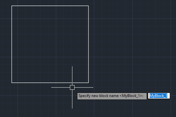

sketch11 started following Rename block
Was looking for something to rename blocks, and have found Lee Mac's code robust since it can handle dynamic blocks, and renames only the particular block selected, so it has a unique name. https://www.lee-mac.com/copyblock.html How can code be adjusted for the following. 1. Select block first, then run code (will right click to select command which runs code). At the moment code is called up, then block is selected. 2. When block name is changed, it will be at the end of the string, based on existing name. Tried to press End on keyboard to get to the end of the name but this won't work, the arrow keys do work but it starts from the beginning. See below.
