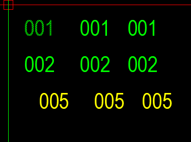

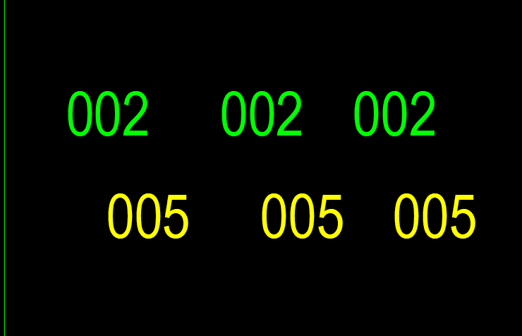

  5. leonucadomi
    ATTDEF COUNT...help
    sorry , I will try to explain myself again the routine you created selects texts and attributes, that's excellent. What I would like you to show is... example: color green texts color yellow ATTDEF att That is, of the total number of selected objects, how many are texts and how many are ATTDEF , regardless of how many times its tags are repeated. another example: number of selected texts : 6 number of selected ATTDEF : 3 I needed Excel to account for them, but if all the amounts are shown here it is very helpful and Excel is not necessary. thanks

  11. BIGAL
    ATTDEF COUNT...help
    " how many times each tag is repeated. " that is in the answer I provided. (("048" 1) ("047" 1) ("046" 1) ("045" 2) ("044" 1) ("043" 2) ("042" 1) ("041" 2) ("040" 1) ("039" 1) ("038" 2) ("037" 1) ("036" 2) ("035" 2) ("034" 6) ("033" 6) ("032" 6) ("031" 2) ("030" 2) ("029" 12) ("028" 6) ("027" 6) ("026" 23) ("025" 2) ("024" 4) ("023" 6) ("022" 6) ("021" 1) ("020" 1) ("019" 2) ("018" 2) ("017" 1) ("016" 1) ("015" 2) ("014" 6) ("013" 2) ("012" 2) ("011" 2) ("010" 1) ("009" 1) ("008" 1) ("007" 1) ("006" 4) ("005" 16) ("004" 1) ("003" 1) ("002" 1) ("001" 1)) change code at end add princ lst3 ) (princ lst3) (princ) ) I can do the send to excel if you want ? You have asked for text also can you post anther sample dwg with say both, text and Attdef. Will have a think about missing value.

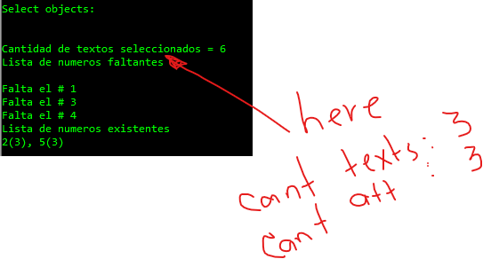

  12. GLAVCVS
    ATTDEF COUNT...help
    var1, var2, and var3 should be "punto," "angulo," and "distancia"? So: angle and distance... between what objects?

  16. GLAVCVS
    ATTDEF COUNT...help
    ;BACALADO DE BILBADOOO (PLUS) (defun nqf (tuSS / i lista tipObj cant cad txs atts) (princ "\nNumero que falta") (terpri) (if tuSS (setq cant (sslength tuSS)) (progn (alert "No existe conjunto de seleccion o esta vacio") (exit) ) ) (princ "\nCantidad de textos seleccionados = ") (princ cant) (princ "\nLista de numeros faltantes") ;Pasar del SS a una lista de valores (setq i 0 txs 0 atts 0) (repeat (sslength tuSS) (setq tipObj (cdr (assoc 0 (setq le (entget (ssname tuSS i))))) num (atoi (cdr (assoc (if (= tipObj "TEXT") 1 2) le))) i (1+ i) lista (if (setq l (assoc num lista)) (subst (list num (1+ (cadr l))) l lista) (append lista (list (list num 1))) ) ) (if (= tipObj "TEXT") (setq txs (+ txs 1)) (setq atts (+ atts 1))) ) ;Imprimir los valores que no aparezcan (terpri) (setq i 1) (princ (strcat "\nLista de numeros existentes\n" (while lista (if (setq v (assoc i lista)) (setq cad (if (= (cadr v) 1) (if cad (strcat cad ", " (itoa (car v))) (itoa (car v)) ) (if cad (strcat cad ", " (itoa (car v)) "(" (itoa (cadr v)) ")") (strcat (itoa (car v)) "(" (itoa (cadr v)) ")") ) ) lista (vl-remove v lista) ) (princ (strcat "\nFalta el # " (itoa i))) ) (setq i (1+ i)) cad ) "\nTextos: " (itoa txs) "\nAtributos: " (itoa atts) ) ) (princ) ) (defun c:nqf nil (nqf (ssget '((0 . "TEXT,ATTDEF")))))

  23. leonucadomi
    ATTDEF COUNT...help
    you can make the routine show the number of selected texts and the number of attributes, please
