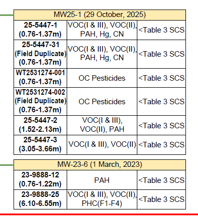

Automatically placing borehole tables with leaders without overlap
BIGAL replied to MSHR's topic in AutoLISP, Visual LISP & DCL
A big table of all the boreholes can be made looking like this. Think of it as more than two vertically, yes can have a color background. Is that ok ? Can be sorted by date or name. -
