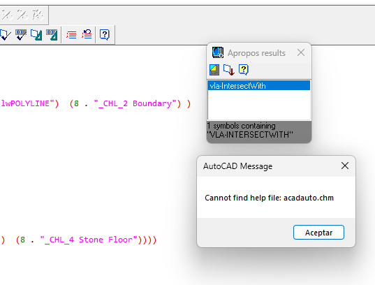

devitg started following acadauto.chm not found
Using APROPS at VLIDE I get this alert. Please route me where it shall be . I have the file , but VLIDE did not found "C:\Program Files\Common Files\Autodesk Shared\en-US\acadauto.chm"
