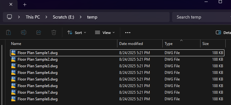

Danielm103 posted a topic in .NET, ObjectARX & VBA
For these examples, I’ll be working with a folder with copies of the same drawing, pretend they’re floors of the same building or something -
