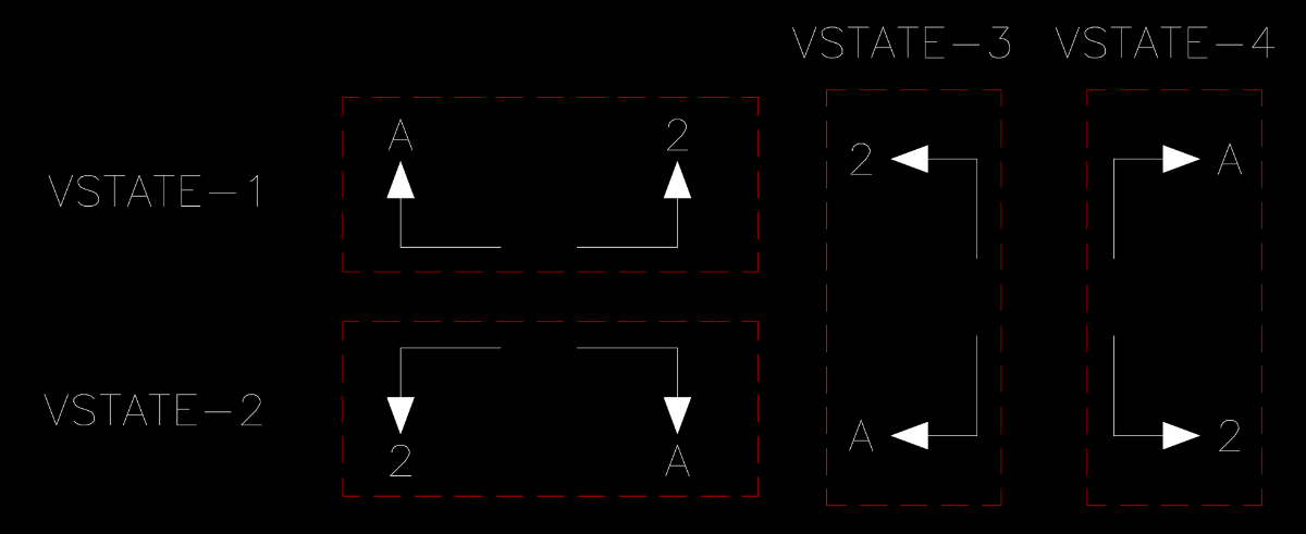

I want to create a dynamic block with 4 visual states. I want two text values to appear in each state but in different places in each state. If I understand correctly you cannot move an attribute from state to state. Fields would work but I have no way of knowing how many of these blocks may be needed in a particular drawing. If I copy the attributes from VS to VS when creating the block, they only are available in the first state. The other states report there is no editable attributes but if I edit the state they are there. Here is a diagram of the 4 visual states. (the red is not part of the block, just a separator) I had created a block with 8 attributes but users found it confusing or difficult to navigate. Is there a way to achieve this in a simpler/better fashion?-
