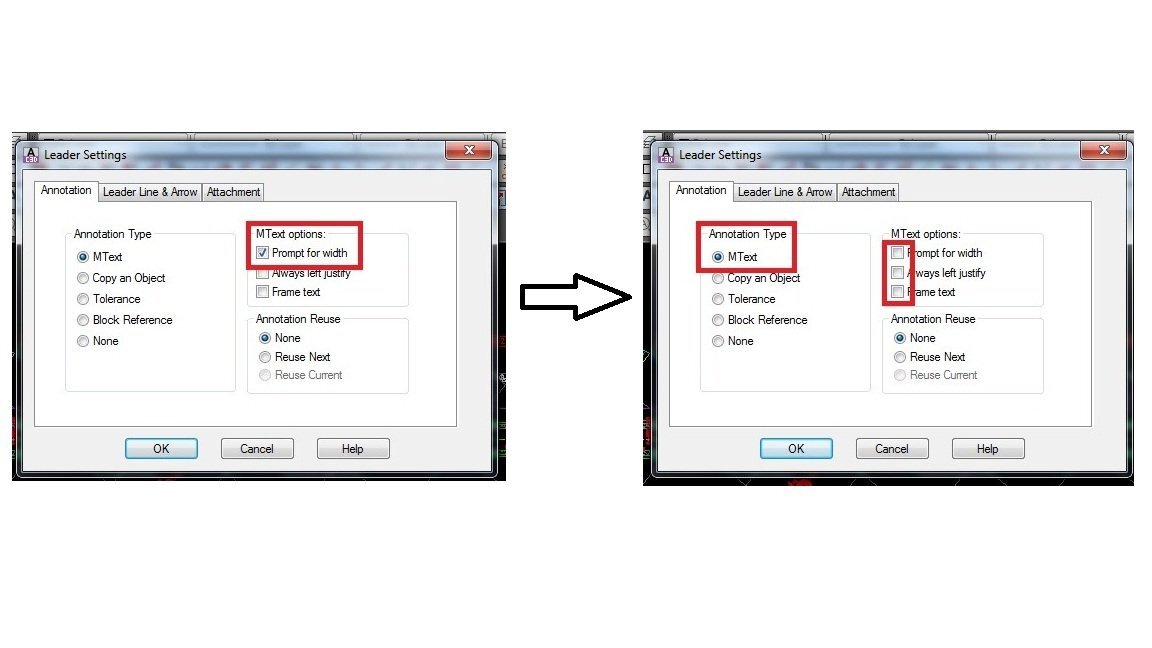

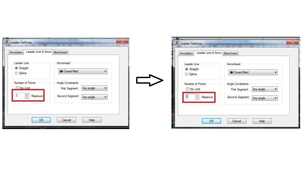

reza posted a topic in AutoLISP, Visual LISP & DCL
Hi everyone When I open a dwg file and use the attached lisp to change the Qleader settings, no changes are made to the settings. Please fix the problem for me. qlset.lsp.lsp test.dwg - Today
