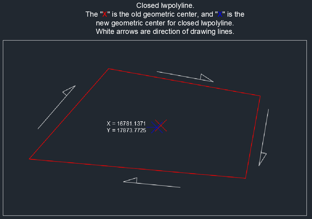

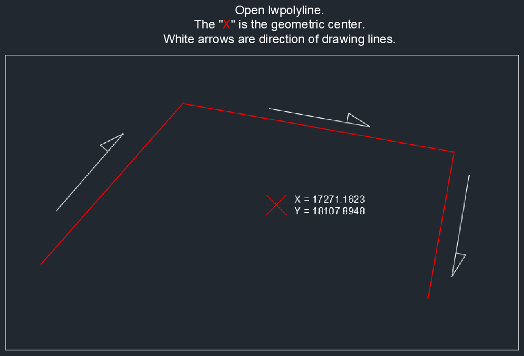

Geometric center of open polyline, line
Saxlle replied to maahee's topic in AutoLISP, Visual LISP & DCL
You can actually calculate it, here is the code (you can change it for your purposes): (setq ptlist (mapcar 'cdr (vl-remove-if-not (function (lambda (x) (= (car x) 10))) (setq ent (entget (car (entsel "\nSelect the line:")))))) ;; point list sum_x 0 sum_y 0 vertices (cdr (assoc 90 ent)) ;; number of vertices for LWPOLYLINE ) (foreach pt ptlist (setq sum_x (+ sum_x (car pt))) ;; sum only the X vertices values ) (foreach pt ptlist (setq sum_y (+ sum_y (cadr pt))) ;; sum only the Y vertices values ) (setq sum_x (/ sum_x vertices) ;; dividing the total sum X by the number of vertices sum_y (/ sum_y vertices) ;; dividing the total sum Y by the number of vertices pt (list sum_x sum_y) ;; geometric center ) Below are the pictures with geometric center for open and closed polyline (picture 1 open, picture 2 closed). Picture 1. Picture 2. This is true. Best regards. -

Only the geometric center is available for closed areas, since open polylines have no area and therefore no true center. If it’s just a line, the "geometric center” is the midpoint. - Today

(setq gct (osnap (vlax-curve-getStartPoint bm) "gcen")) The above code line gives only closed polyline How to find the geometric center of an open polyline and a single line
