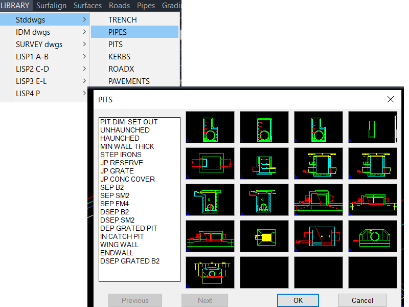

Very good the circle maths can be very complex. One suggestion would be to do the osnaps so correct for next step.
Maybe use a 4x3.dcl  of the images so can pick which option rather than just defun name.
