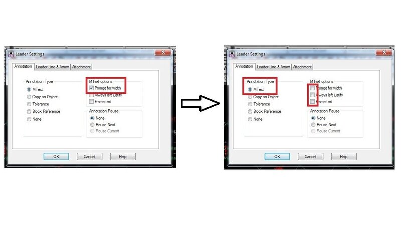

reza posted a topic in AutoLISP, Visual LISP & DCL
Hi everyone When I open a dwg file and use the attached lisp to change the Qleader settings, no changes are made to the settings. Please fix the problem for me. qlset.lsp.lsp test.dwg -

That LISP the is not original AFAIK. It is a couple of functions, you need to call for it with a LISP to make the settings, etc. Several places to get the correct QlSet.lsp and example LISPs to use it. Qleader lisp routine - AutoLISP, Visual LISP & DCL - AutoCAD Forums Qleader System Variables - AutoLISP, Visual LISP & DCL - AutoCAD Forums qleader lisp - AutoLISP, Visual LISP & DCL - AutoCAD Forums assigning q-leader settings using lisp- 1 reply
- 1
	Problem is the number of pauses you need is dependant on the current qleader settings. Frank Whaley at Autodesk created qlset.lsp that can set any qleader settings to fit whatever you want to do with your qleader lisp and reset those settings afterwards if you wish. I've attached qlset.lsp and lead.lsp I wrote years ago as an example you can modify to suit your needs. I'd suggest reading Frank Whaley's code first to see all it can do. If you search for qlset.lsp you'll find many other examples. lead.lsp qlset.lsp

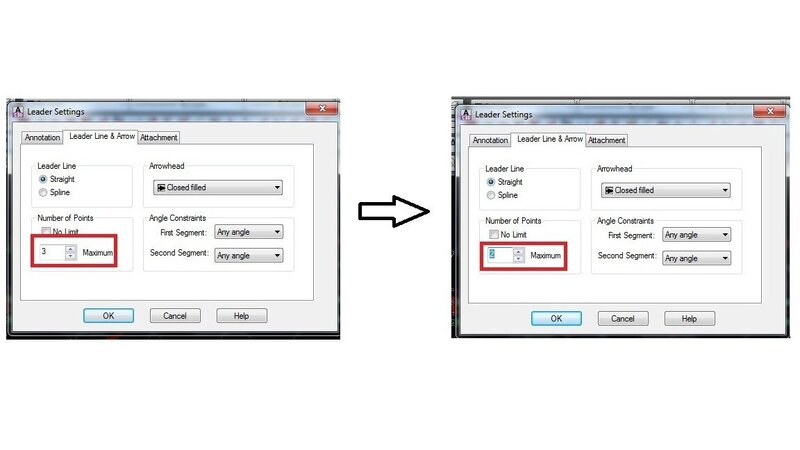

There are 14 different settings that affect options for the qleader command. For a lisp to work consistently for multiple users you would need to set the options for number of vertices and either text or mtext using the qlset.lsp by Frank Whaley at Autodesk. It's been posted on this forum many times already: https://www.cadtutor.net/forum/search/?q=qlset I'd recommend resetting those settings at the end of the lisp to avoid upsetting another user whose settings aren't exactly the same as yours. -

	Start command, click [settings] or Enter, then click 'Leader Line & Arrow' tab, and modify Maximum Number of Points. To do it with lisp use the qlset.lsp. See http://www.cadtutor.net/forum/showthread.php?38397-qleader-lisp
