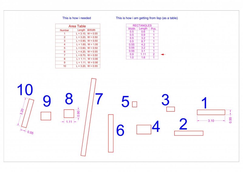

Hai all, i have a lisp that gives me Length and Width of Rectangles that i select into a Table in cad. the table gives me the length and width as per incremental in size (eg:{ 1x2, 1.2x2, 2.1x3 } like wise) i have attached a screenshot of this, and also joins same size rectangle in one cell and shows number as 2. What i need help is to get the table not as incremental values but as i select (1st selection in first cell, 2nd in second cell like that). Please check the Screen shot. i don't know how to change the codes, the lisp is from a friend i got. so please help if possible , thanks in advance.. Please check the image ive uploaded too. the lisp code: (defun rectangle_dims (e / l a b) (setq l (mapcar 'cdr (vl-remove-if '(lambda (x) (/= (car x) 10)) e))) (if (and (or (= 1 (logand (cdr (assoc 70 e)) 1)) (equal (car l) (last l) 1e-8) ) (equal (distance (car l) (caddr l)) (distance (cadr l) (cadddr l)) 1e-8) (equal (mapcar '- (cadr l) (car l)) (mapcar '- (caddr l) (cadddr l)) 1e-8) (equal (mapcar '- (caddr l) (cadr l)) (mapcar '- (cadddr l) (car l)) 1e-8) ) (vl-sort (list (distance (car l) (cadr l)) (distance (cadr l) (caddr l))) '<) ) ) (defun C:RECDIMS (/ acObj acDoc space *error* ss e old r p1) (vl-load-com) (setq acObj (vlax-get-acad-object) acDoc (vla-get-activedocument acObj) space (vlax-get acDoc (if (= 1 (getvar 'cvport)) 'PaperSpace 'ModelSpace)) ) (vla-startundomark acDoc) ;;;;;; Error function ;;;;;;;;; (defun *error* (msg) (and msg (not (wcmatch (strcase msg) "*CANCEL*,*QUIT*,*BREAK*")) (princ (strcat "\nError: " msg)) ) (vla-endundomark acDoc) (princ) ) ;;;;;;;;;;;;;;;;;;;;;;;;;;;;;;; (if (setq ss (ssget '((0 . "LWPOLYLINE") (-4 . "<OR") (90 . 4) (90 . 5) (-4 . "OR>")))) (progn (repeat (setq i (sslength ss)) (setq e (ssname ss (setq i (1- i)))) (if (setq dims (rectangle_dims (entget e))) (if (setq old (vl-some '(lambda (d) (if (equal (list (cadr d) (caddr d)) dims 1e-8) d)) r)) (setq r (subst (cons (1+ (car old)) dims) old r)) (setq r (cons (cons 1 dims) r)) ) ) ) (if (and r (setq p1 (getpoint "\nSpecify table insert point: "))) (insert_table (mapcar '(lambda (a) (list (cadr a) (caddr a) (car a)) ) (vl-sort (vl-sort r '(lambda (a b) (< (caddr a) (caddr b)))) '(lambda (a b) (< (cadr a) (cadr b)))) ) p1 ) ) ) ) (princ) ) ;;The textheight in table depends on cannonscale (defun insert_table (lst pct / tab row col ht i n) (setq ht (/ 2.5 (getvar 'cannoscalevalue)) pct (trans pct 1 0) n (trans '(1 0 0) 1 0 T) tab (setq tab (vla-addtable space (vlax-3d-point pct) (+ 2 (length lst)) (length (car lst)) (* 2.5 ht) ht)) ) (vlax-put tab 'direction n) (mapcar (function (lambda (rowType) (vla-SetTextStyle tab rowType (getvar 'textstyle)) (vla-SetTextHeight tab rowType ht) ) ) '(2 4 1) ) (vla-put-HorzCellMargin tab (* 0.14 ht)) (vla-put-VertCellMargin tab (* 0.14 ht)) (setq lst (cons '("Width" "Length" "Pcs.") lst)) (setq i 0) (foreach col (apply 'mapcar (cons 'list lst)) (vla-SetColumnWidth tab i (apply 'max (mapcar '(lambda (x) ((lambda (txb) (+ (abs (- (caadr txb) (caar txb))) (* 2.0 ht))) (textbox (list (cons 1 (vl-princ-to-string x)) (cons 7 (getvar 'textstyle)) (cons 40 ht))) ) ) col ) ) ) (setq i (1+ i)) ) (setq lst (cons '("RECTANGLES") lst)) (setq row 0) (foreach r lst (setq col 0) (vla-SetRowHeight tab row (* 1.5 ht)) (foreach c r (vla-SetText tab row col (vl-princ-to-string c)) (setq col (1+ col)) ) (setq row (1+ row)) ) ) (princ "\nType RECDIMS to start the command")
