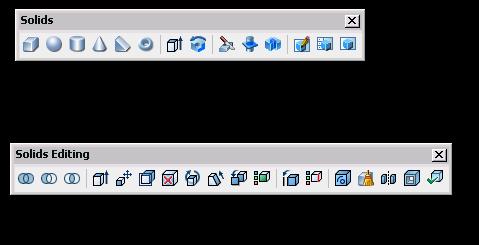

arjun_samar Posted May 2, 2009 Posted May 2, 2009 all of them drawed with "lines". So I think I can say I'm between steps 2 and 3. i think friend drawed them with lines the wall and etc.. is not the right way of making it 3d.... the link that mr. cad64 posted is very excelent help for you... you should check it... thier are many topic on 3d commands be familliarise with it... 3d object having value of xyz lentgh width and hieght. ok in 3d creation there are 3 types of 3d (i guess:D hehehehe) 1. 2d wireframe-using lines to draw at xyz axis this can have 3 3d effect look but the truth its not totally a 3d objects..... 2. surface model -a 3d model without mass or hallow inside. 3. solid model- a 3d model with mass ( literally mass ) mostly this is the best 3d type that are using in creation of 3d house... (easy to edit) 3d is like 2d if 2d creation first using draw commands then editing it by edit commands like trim etc. in 3d also it goes that way. first using 3d commands to create 3d object then editing it by solid edit commands. important things in 3d modelling 1. 2d commands. (for construction puposes and etc.) almost all commands 2. 3d commands for 3d creation these are 3d com. that are often use. a. extrude (solid command) - giving a thikness of a 2d of object or by converting it to 3d solid. b. slice (edit command) - cutting a 3d object.. c. subtract (edit command) - subtracting 1 3d object by using a another 3d object as an subtraction object. the UCS- user coordinate system... its the icon on the left of the screen this is important the ucs. the 3d view 3d orbit iso views here is another link... http://www.dailyautocad.com/autocad/3d-modeling-1-introduction/ Quote

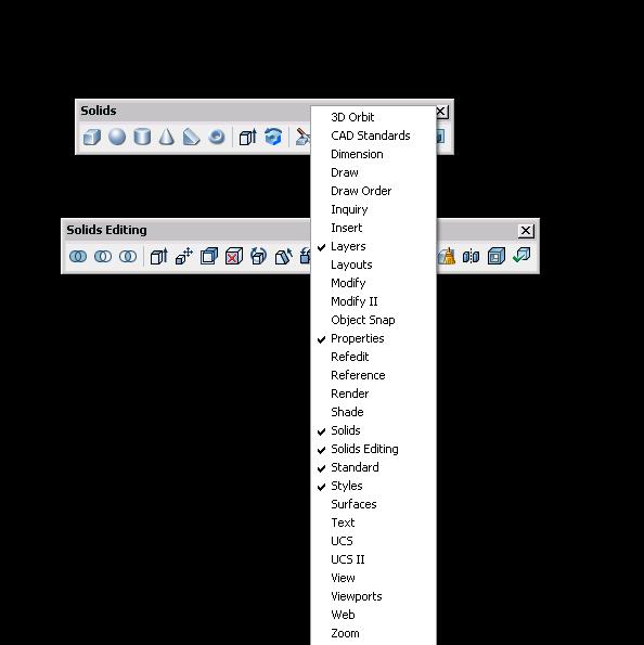

arjun_samar Posted May 2, 2009 Posted May 2, 2009 check this toolbar... to open new toolbar right click on existing tool bar then a menu will appear select the solid and solid editing... just go to help menu (F1) for more info in the in the commands under the solid and editing tool bar.. Quote

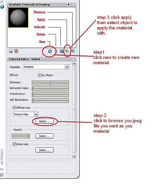

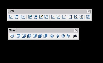

Neo987 Posted May 3, 2009 Author Posted May 3, 2009 Just finished the 3d walls, windows(almost) and doors.Now the next step I think is to put some materials on these surfaces. So how can I put materials that I want from a Jpeg file let's say? Plan step 3: P.S. Any ideeas on how to make windows on curved surfaces because I'm really having trouble making "region" and "extrude" windows because it says the are not complanar, and making "box" and "subtract" also doesen't work! Quote
arjun_samar Posted May 3, 2009 Posted May 3, 2009 on the non co-plannar,coz it not along on x,y axis. go to acad help menu type ucs to find more info on this.. to apply materials type in the command line rmat a pallet will apear. Just finished the 3d walls, windows(almost) and doors.Now the next step I think is to put some materials on these surfaces. So how can I put materials that I want from a Jpeg file let's say? are you trying to apply your own jpeg file or image as material? if yes here is a snapshot on how to do it. and autocad have a buit-in materials pallet (a selection of materials) just Ctrl+3 to open the tools pallet. here is a link you can download an ebook here register first dont worry its free. just download the ucs topic and materials topic. http://www.dailyautocad.com/e-books/ Quote
