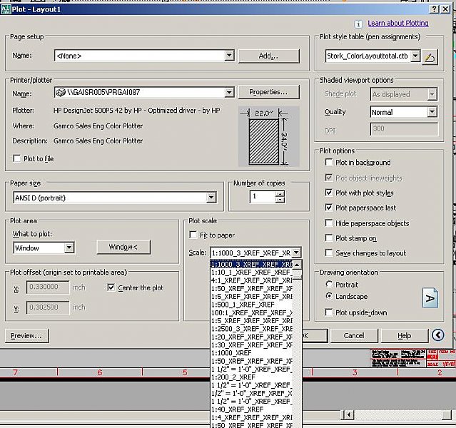

JoeC Posted May 4, 2009 Share Posted May 4, 2009 Hello all...Lately, some of us have been seeing the attached plot screen. Notice all of the Xrefs listed at the Pot Scale setting. Of course this makes it difficult to find the desired plot scale. The drawing contains no Xrefs, but it does have quite a few layers with "$0$" in the layer name. 2 Questions: What is causing this, and how do we correct it? Many thanks for your input. Quote Link to comment Share on other sites More sharing options...
rkent Posted May 4, 2009 Share Posted May 4, 2009 Service Pack 1 from Autodesk fixes this so any future ones won't appear. http://usa.autodesk.com/adsk/servlet/ps/dl/item?siteID=123112&id=10035892&linkID=9240618 Also go here and download DBXremSL.VLX, DBXscanSL.VLX. http://www.cadforum.cz Run that to delete the scales for the drawings you specify. Quote Link to comment Share on other sites More sharing options...

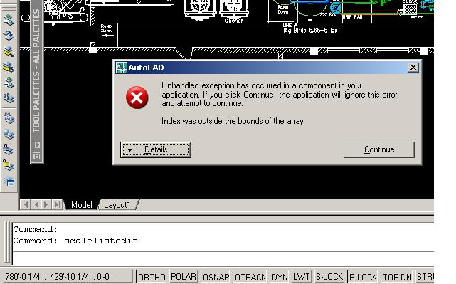

JoeC Posted May 5, 2009 Author Share Posted May 5, 2009 My IT dept tells me that we have SP2 installed. I checked with Autodesk, and they said to use the SCALELISTEDIT command to modify the scales loaded into the drawing. (They tell me that this is a result of various scales that were part of the Xrefs which may have been part of this drawing at one time.) Anyway, I tried the SACLELISTEDIT command, and got the error in the attachment below!?!? (Forgive me if this should be a different post) Anyone know what this means? I posed the question to Autodesk, but it usually takes 24 hours for an answer from them. Thanks. Quote Link to comment Share on other sites More sharing options...
JoeC Posted May 6, 2009 Author Share Posted May 6, 2009 O.K. In case anyone is interested, Autodesk helped me correct the numerous "Xref" scales in the plotscale menu. COmmand line "-SCALELISTEDIT" (be sure to use a dash (-) before the word), and then select "Reset". This resets all of the scale choices to default. Quote Link to comment Share on other sites More sharing options...
