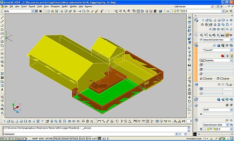

kjetilhansen Posted May 4, 2009 Posted May 4, 2009 Hi. Can anybody help me whit this? The problem is that i see the block behind the other blocks... What can i do? Thanks. Quote
jamiegreig1987 Posted May 5, 2009 Posted May 5, 2009 Are you going to render this? If you are going to render this it will clarify the issue you are having! Quote
kencaz Posted May 10, 2009 Posted May 10, 2009 I had a similar bleeding problem. Try entering "3dconfig" at the command line, Under "Manual Tune", select "Enable hardware acceleration" This all but solved my bleeding problems. If you already have it Enabled, try some of the other parameters and hopefully you will get better results. KC Quote
