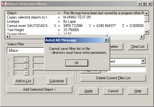

Can someone please tell me why this is? Works great in 2008 but gives me this error in 2009. And yes I have full permission to the directory. Already double checked with my IT Admin. :(

When I switched from 2004 to 2008 I put the Filter.nfl file in
C:\Program Files\Autodesk\ACADM 2009\Support
At the time, there were Filter.nfl files scattered throughout my hard drive. Since eliminating all other copies and putting one early in the “Support File Search Path”, the file has been behaving.
