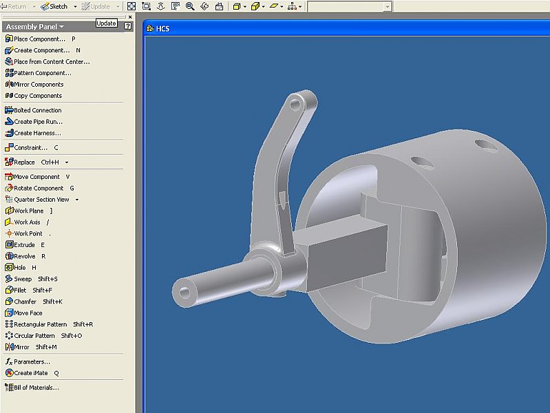

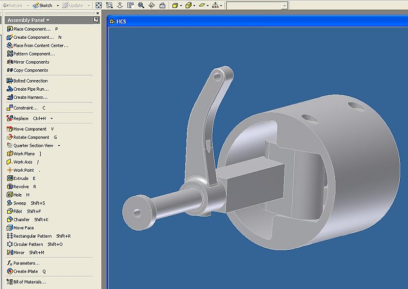

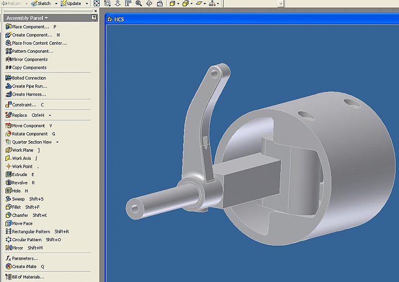

here are 3 screen shots. the first shows the dim button after just opening both files, the second shows the assembly after the part file has been modified and saved, the third shows the file after update has been clicked. its again dim and not selectable because there are no updates.

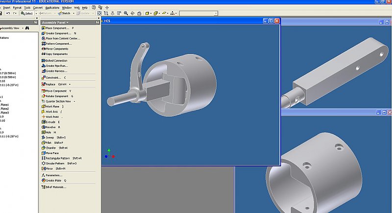

Ok. I found the problem. Most of the time I am running two instances of inventor. One on each of the two monitors I have. If I edit the ipt in one instance the other basically doesnt know whats going on.
Anyway around that? Thanks Shift.
why do you need two instances open? You can have multiple part windows open at the same time. I cant remember if it was inventor or SW but one has an option to stretch out over dual monitors. If you are working with an assembly you can select your part, edit it and change the transparency of the other components.
My strong recommendation is to not work with multiple instances open. As Matt said you can have more than one part open at a time in a single session. The reason is exactly what you have already seen, when one "user" (or in this case one instance of Inventor) edits a part, the cached information wont update in the other session. Essentially one instance becomes "out of date". This is what vault and semi-isolated projects are meant to control.

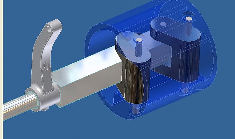

Here is a pic of a curve driven component pattern.
