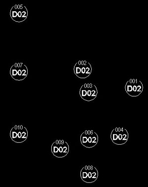

And one other question. For some projects, we have multiple types of piles. Each piletype is a diffrent block symbol with the same Tag for number. As the lisp works now, it only searches for Tag's within one blockname. Could it look in diffrent blocknames for the same Tag and increment those numbers?
Kind regards!
  • 3 years later...
On 2/8/2008 at 10:26 PM, ASMI said:
1. Specify start number
2. Pick to wanted attribute
3. Select blocks and press Spacebar
Enjoy...
