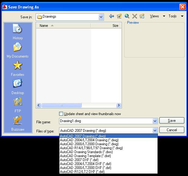

You do a File Save As... to an earlier version.
Here is an image of the dialog.

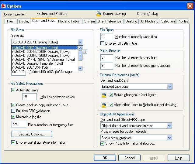

Here is another way with Options, So you do not have to worry about this every time you save a drawing. After it is set here it will aways save to an earlier version of your choice if you just click to Save.
I think it is best to save to earlier versions so the drawings can be shared with others if you choose.

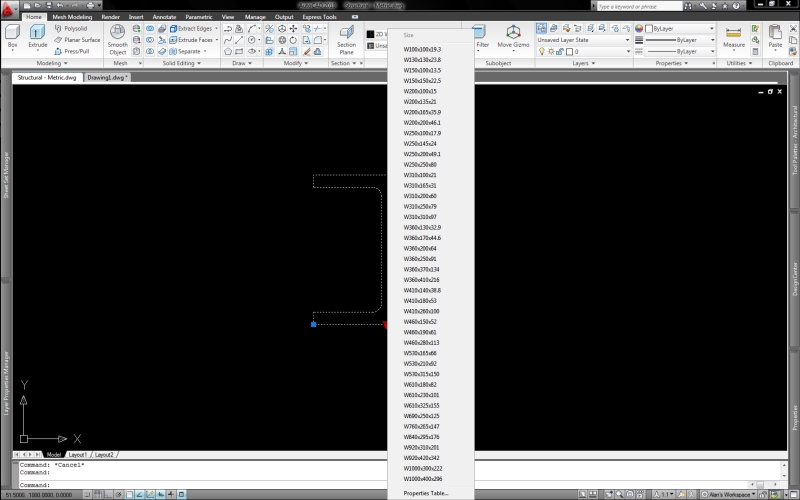

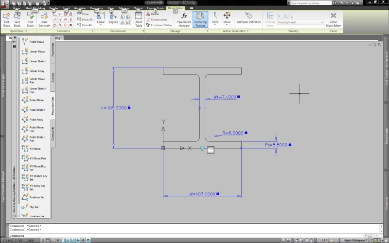

OK, some pictures showing the new Parametrics as they are in 2010 and an Autodesk 2010 file with Dynamics Saved As 2007. Play with it, edit it and resubmit it and we'll see what the go is...
Structural - Metric.dwg

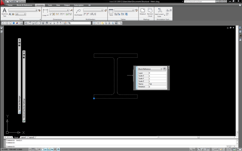

Preempting your response, here are the results in 2009. Opens fine, recognized as a Block, but you can't use the Block Editor on it because it's one of those horrible Unnamed Blocks (in this case *U1) that you can't deal with other than to explode it (but you wouldn't do that to me, now would you?).
Open it in 2010 and it's all back to working fine (even with other edits to the drawing) provided of course you didn't explode it... So, basically, it's just a bit of tough luck if you want to change the 2010 specific objects because they just won't work without exploding these Blocks.
Well, at least you all know what to watch out for now... Ever get the feeling that I don't like people who explode :roll:
