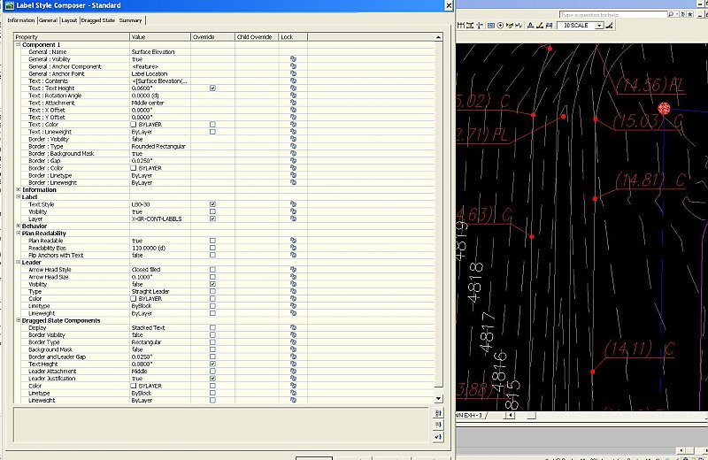

courtfetter Posted May 14, 2009 Share Posted May 14, 2009 I've completed my contour labeling and the labels have a vertical line through the center of them. Is this an anchor point? It looks liek my station tic. How do I get rid of it? The labels are on a custom layer(x-cont) so that they may be frozen in other viewports. However in the other viewports, when freezing the "x-cont" layer only the label freezes but leaves this same line behind. I attached the 2 viewports images. How do I fix this? Quote Link to comment Share on other sites More sharing options...

lpseifert Posted May 15, 2009 Share Posted May 15, 2009 In the Contour Label Style, is the Background Mask = True? (under Border) also... the contour labels done individually are essentially the same as the labels done as multiple. If you select a contour label, 3 grips appear; if you drag one of the end grips across another contour(s), labels should appear. Quote Link to comment Share on other sites More sharing options...

courtfetter Posted May 15, 2009 Author Share Posted May 15, 2009 I'm not sure what setting your referring to. I have the attached image settings configured. Quote Link to comment Share on other sites More sharing options...
alanjt Posted May 15, 2009 Share Posted May 15, 2009 it's in the feature settings. i had to look for it again. Quote Link to comment Share on other sites More sharing options...
courtfetter Posted May 17, 2009 Author Share Posted May 17, 2009 That go rid of the line, thanks. But now I don't have any masking?!?!?!? I understand that the only section where the masking is controlled is under surface/label style/contour/Standard. I've edited this "Standard" several times changing the background mask from true to false under the border section but it does nothing. This should't be this hard AUTODESK!!! Quote Link to comment Share on other sites More sharing options...
