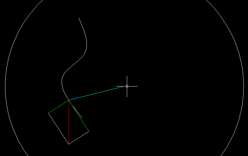

Please find attached an example of the first part of what I want the AutoLISP routine to do. The red segment is the vector to be decomposed. Green segments are the components of said vector along the normal and the tangent of the curve. These components can be found by hand but what I'm expecting is that there should be an AutoLISP routine to do this automatically.
After this is done the green tangential component should be further decomposed (not shown in this illustration to not burden it) into its components along the line depicted in Cyan which connects the point on the curve with the center of the circle on the one hand and the perpendicular to that line on the other. Finally the length of that line is to be multiplied by the length of the component of the initial vector perpendicular to said line.
vector_decomposition_along_normal_and_tangent.dxf
Here's a screenshot (see attached). Hope it'll be OK.
So are you saying that the user will pick the red line and the curve?
Correct. Only the particular point on the curve has to be picked, however.

Thanks Lee. That looks like a step in the right direction. However, what needs to be done is to select the Red line (the vector in question) whose components are to be found along the normal and the tangent to the curve as well as select the curve.
In your code the circle is selected first and then when selecting the curve, aside from the properly drawn radius, the components of the vector are not recalculated. Say, for instance, you draw a longer vector that needs to be decomposed -- you'll see that the components your code draws aren't the ones that correspond to the new vector but are retained, that is, are the already existing components from the original vector.
My code merely displays the tangent and normal vectors of that particular point on the curve.
I shall modify it to see what I can do :)

Give this a shot:

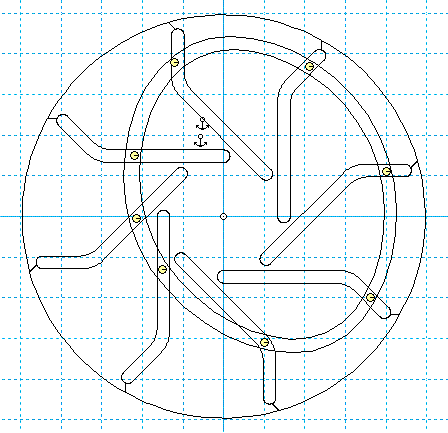

@SEANT,
This calculates the torques on the eight weights on an unbalanced wheel similar to this one:
@SEANT,
And, as far as the hands I'm in, I'm speechless.
Lee, I think this is absolutely fantastic. Can't believe my eyes.
Is it possible now to apply the same concept and decompose the obtained tangential component further into a component along the radial line and, especially important, a component along the perpendicular to the radial line?
