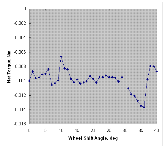

As for the signs of the derivatives, the check should be as to whether or not the radial line is to the left or to the right of the point on the curve where the second derivative is zero. If it's to the left then the torque is positive, if it's to the right torque is negative.
I'm very sorry, but could you possibly upload a 2004 format drawing depicting exactly the position of how you want the vectors, and illustrating when it should be positive or negative.
You say, when the second derivative is zero, hence the extremums of the first derivative, but which curve are we talking about?
Sorry if I sound a little confused, but I want to get this right :)
As for the continuity of the selections, try this (I have reverted back to an earlier code post) - without any sign checking.

Here's an example of correct sense the vectors should have (see attached). If you try these with the code you'll see that some vectors are reversed.
The curve whose extremums are sought is the blue curve. Wonder if there wouldn't be another method, different from determining the second derivative because the "curve" in fact consists of small segments. Say, finding the largest and the lowest y-axis value of any point of that curve. Maybe, any radial line consisting of points with y-axis value greater that the y-axis value of the center on the one hand and having no x-axis points to the right of the x-axis value of the topmost point on the curve (we should have that value from the earlier test) would set the sign of the torque calculated with that radial line as positive. However, if any such radial line (having all y-axis points above the y-axis of the center) has x-axi points to the right of the x-axis of the topmost point on the blue curve (we already have this x-axis value from the previous test) then the torque in which the observed radial line participates is negative. What do you think about this method?
example.dxf
Yes, that last code is excellent. Now we have to work on the sense of vectors and, most importantly, on the signs of the torques.

Why is the blue curve made up of so many segments? Can't it be just one Polyline? The routine would work a lot better than way, and it would be much easier to work with.
See, that's probably the biggest constructive problem in that whole project. That the gist of the whole thing and the point of optimization. It should be smooth and the Polyline isn't smooth enough. The spline cannot be shaped as needed and it has nodes. I don't know, this has to be really though over. At the moment what I thought might be the solution is to use the table of all the data that belong to the blue curve and and use them for testing the position of the radial line. Do you think that's possible. It will work even if ther's an analytical line, I think.
Calculations would be a hell of a lot easier on one complete curve, and the program would flow a lot better.
See my attached drawing to see what I mean.
I hope I have sorted the problem with signs:

Now, take a look what I did today. This is a plot of the net torques at positions of the wheel of one degree difference (see attached). You can imagine what busy work that is. Your code helped immensely, though.
The 30 degree has to be redone due to problems with the program, that's why it isn't there. Will have to try it with your curve but we'll have to fix the code to make it even more user friendly, aside from the sign issue.
