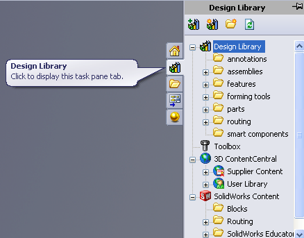

WagglyFawn Posted May 19, 2009 Share Posted May 19, 2009 Is there one? For those who haven't used Inventor, I'm looking for something like it's Content Center, which is basically a library of commonly used features and hardware pieces such as various angle iron sizes, nuts, bolts, etc. Quote Link to comment Share on other sites More sharing options...
JD Mather Posted May 20, 2009 Share Posted May 20, 2009 Check out Design Library and Toolbox. Quote Link to comment Share on other sites More sharing options...
WagglyFawn Posted May 20, 2009 Author Share Posted May 20, 2009 Wow, I must not have the entire design center or toolbox installed because it's a joke compared to Inventor's Content Center. Thank you very much for you help, though. That is what I was looking for. Quote Link to comment Share on other sites More sharing options...
shift1313 Posted May 25, 2009 Share Posted May 25, 2009 there is also that bolt below it(toolbox). There is a lot of stuff in there. Content Center is loaded but ive never compared the two back/back. Quote Link to comment Share on other sites More sharing options...
WagglyFawn Posted May 27, 2009 Author Share Posted May 27, 2009 I have the basic version of Solidworks 2009. Is toolbox included with it? I try to enter it and it simply states "Toolbox not installed". I looked under add-ins as well and it's not shown. Quote Link to comment Share on other sites More sharing options...
shift1313 Posted May 27, 2009 Share Posted May 27, 2009 do you have the installation cds? If the solidworks toolbox or toolbox browser isnt listed in your Add-ins then it wasnt installed and needs to be installed from the cd(i think). There is a content central(online) if you click on the globe icon. Ive never used this but i believe you can get contant that way as well. Quote Link to comment Share on other sites More sharing options...
WagglyFawn Posted May 27, 2009 Author Share Posted May 27, 2009 Nevermind I just called tech support and toolbox isn't supported in standard version. Quote Link to comment Share on other sites More sharing options...
