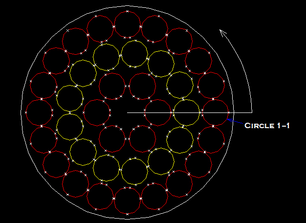

NewGuy,
Just looking at your requirements, would you like the circles to be arrayed from 0 degrees or 90 degrees as the base point.
At the moment, you will notice that all the circles are aligned at 0 degrees, and evenly spaced around the circle from there.
Would you like this allignment at 90 degrees?
Lee
I am not sure what you mean, I do know that what you have done so far is perfect. All I am looking for now is a table to generate and help organize the distances. Could you post a pic?
Give this a shot for the table, I shall post a pic of what I mean :)

File is saved in same place as drawing.
Currently we have:
Would you like the circles arrayed such that:
Oh, yes 90 degrees would be better. Thank you I did not catch that. It is at the 90 degree point that he usually enters the part. Good eye on that one.
YESSSSS! :lol:that is awesome! The table looks perfect! The EDM operator is excited. He says you have saved at least 1 whole day of work each time this type of job comes through. which is quite a few times a year. Are you still going to rotate it 90 degrees? Also I did notice that the center point of the arrayed circles are no longer displayed in the drawing. This is not a big deal at all as we can use the table to extract any distances we may need, but if it is not difficult, and only if it is not difficult, could you add the points back to the center of the arrayed circles? That way if I need to measure from one center to another i can simply use the DISTANCE command instead of doing some trig with the data from the table. Again that is not a big deal at all so don't put yourself out you have done GREAT!!!:D:D
Excellent - I'm glad its how you want it :D
I shall see if I can rotate the base "vector" by 90 degrees for you, and adding the centre point is no trouble at all (about 1/2 a line of code, if that).
Cheers
Lee
This should include the Rotation and Point adding:

That's it!:D You are AMAZING:D You should change your name to "the Amazing Lee Mac"!:lol: At the beginning of all this I really did not think we could get this done. But I shall never doubt your powers again. I hope some day I've got half your skills. How long have you been doing this? Any way, thank you so much for your time and all your hard work. Today is the beginning of memorial day weekend for us on this side of the pond, so if you have an extended weekend too be sure to enjoy it! You have earned it! If anyone asks I'll be sure to tell them Lee Mac is the MAN! Thanks again, have a good weekend. And next week I plan to start learning lisp programing, I am sure I'll need your help. :roll:

Hello Lee Mac, I may have a request for a possible modification to our program. I have been reading some programing tutorials and I noticed that there might be a way to make the table record up to 5 decimal places instead of 4.(The EDM machine actually uses 5 places) I did not think this was possible so I did not ask for it before. Is this possible? Is it difficult? Did you use (getvar "LUPREC")? if so I could create a user template that is set for 5 decimal places in auto cad and use that template when I use your program. Please let me know what you think when you get a chance. Thank you for your time.
This is very simple and easy to do - you can make it display up to 15 decimal places in fact. I shall take a look at it, and highlight what I have changed.
Give this a shot (untested):
