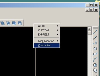

Right-click on an un-occupied gray part of your button bar zone, and select Customize. See first pic.

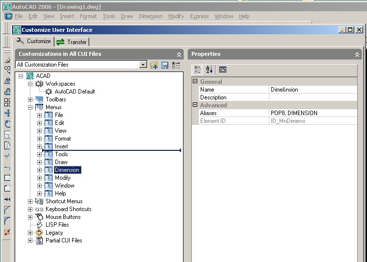

In the resulting CUI window, close Toolbars and hit the + left of Menus. See second pic.
Now you can reposition your menus just the way you want them.
It's a simple drag and drop operation. Pick the one you want to move and drop it where you want it.
In the example, I have selected the Dimemsion menu, and dragged it to just under the Insert menu. The cursor doesn't show in these screenshots.
Word of caution: just like dragging and dropping into a directory in Windows explorer, if you hover too long in one spot, the menu lists will open, and leave you with something you don't want, so make your moves fairly quickly and it will turn out just fine.
After you hit the Apply button, the changes will be made.
