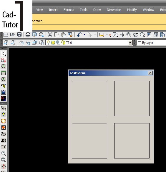

I’m having limited success with assigning the dll resource images to a VBA form. So far, I’ve collected all the necessary api call to read the images from the dll, but a VBA form does seem to expose the appropriate handles to use for image assignment.
I set up a test project with four images (see attached). As it currently stands, it reads the first most image into memory and can easily be assigned to AutoCAD, as the host application, but getting it on the form is proving difficult (see attached image).
It seems like VBA forms have been hobbled compared to their VB6 counterparts. :huh: I’ll keep looking around to see if anything new turns up.
