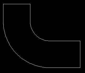

Interior Posted May 27, 2009 Share Posted May 27, 2009 How do i stop the top edge falling when i try to create a ramp or is there a better way of achieving the effecti have posted the shape as a jpeg. and want the ramp to curve round Quote Link to comment Share on other sites More sharing options...

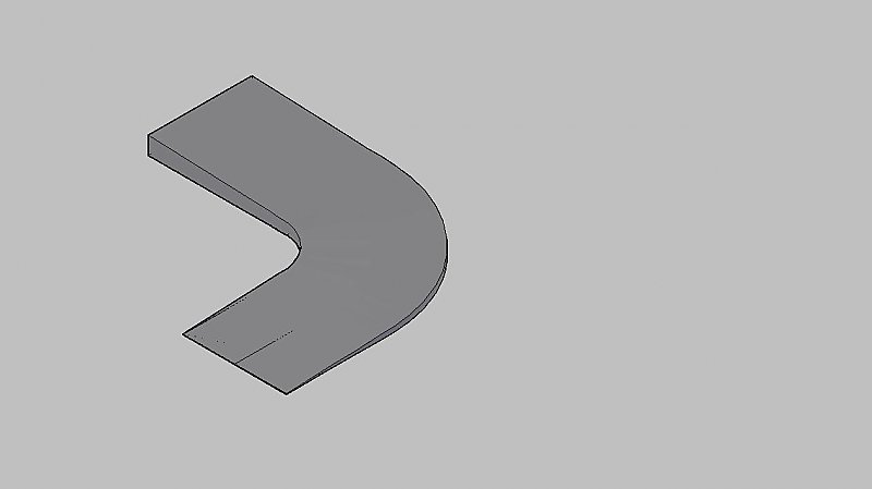

ReMark Posted May 27, 2009 Share Posted May 27, 2009 Something like this? Quote Link to comment Share on other sites More sharing options...
Interior Posted May 27, 2009 Author Share Posted May 27, 2009 Yes like this... when i have tried one corner at the top of the ramp slopes down Quote Link to comment Share on other sites More sharing options...

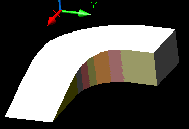

Secretagdan Posted May 27, 2009 Share Posted May 27, 2009 Try the loft command, as seen in my attached image... Make the profiles a bit larger than they need to be, then slice off the bottom to get the desired effect. Im sure that there are other ways to get the desired effect as well. Quote Link to comment Share on other sites More sharing options...

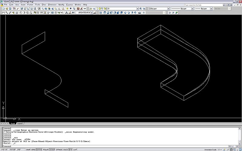

ReMark Posted May 27, 2009 Share Posted May 27, 2009 Not being an "expert" I can only tell you the way I did it and let others point out how much easier it could have been done. I basically set up a centerline path. At each end of the path I used the polyline command to draw a rectangle (width x height). I "cheated" at the tapered end by setting the height to something so small it barely registers. The other end is easy because it is the full height. Then I used the LOFT command to arrive at the final solution of a uniformally tapered ramp. It ain't pretty but it appears to work. Quote Link to comment Share on other sites More sharing options...

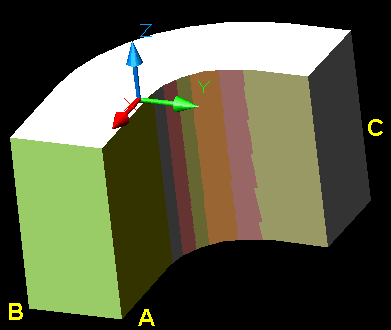

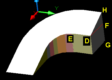

fuccaro Posted October 9, 2009 Share Posted October 9, 2009 Draw the shape as a closed polyline Extrude it. SLICE the solid with a plane defined by points A,B and C (C is somewhere on the vertical line) Slice it again with a plane defined by D,E and F. In the image, the red line is perpendicular to the edge GH Well, this is an "almost ramp". Other possible solutions: - Use surfaces (EDGESURF) - Surfaces, than transform in solid with a Lisp - Use Lisps to draw the ramp. I posted some in this forum Quote Link to comment Share on other sites More sharing options...
