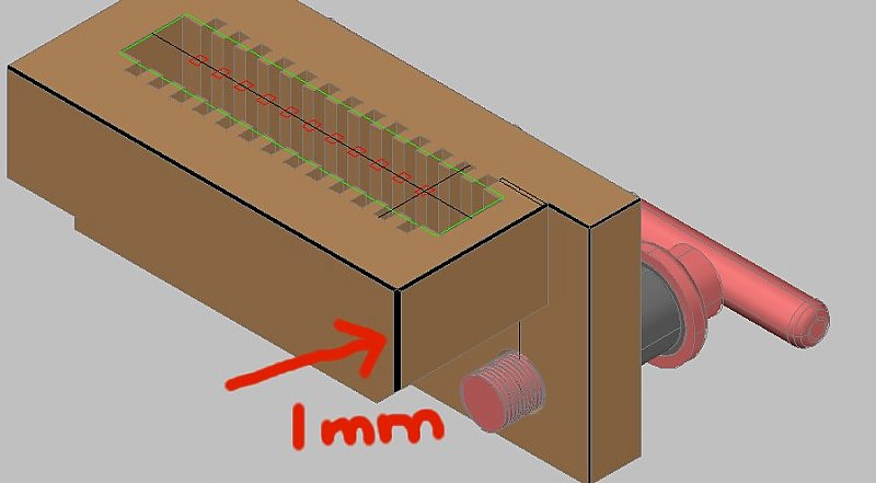

humaironline Posted May 28, 2009 Posted May 28, 2009 i made a tool drawing for my company work. i make 1mm champher and save the file. now i want to make the champher 0.5mm. i dont understand how to do it. Please help me. check the image. Quote
shift1313 Posted May 28, 2009 Posted May 28, 2009 i dont think there is an easy way to alter that in autocad. If you were using something like inventor it would be as simple as changing a number. Someone may have a trick for you but i cant think of any SolidEdit commands that would work in this case so I would probaby redraw the corner as a solid and UNION it with that and perform Chamfer again. Or draw your corner chamfered and UNION that. Quote
Guest Posted May 28, 2009 Posted May 28, 2009 As far as solid editing, you can use the 'delete face' (on the solid editing tool bar), then chamfer again, at the proper chamfer. Quote
humaironline Posted May 29, 2009 Author Posted May 29, 2009 oh...realy thanks Secretagdan.... i am very thankful to you...thats good. i did it. humair. Quote
frankie Posted May 31, 2009 Posted May 31, 2009 Yes, "delet face"it can solove this problem.also can solve fillet problem. Quote
