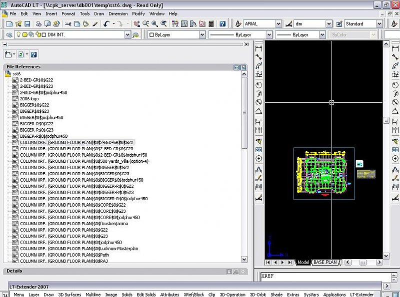

Hello
I have attched an image....pls help me .... I am sick of these unreffered files....
I have removed XREF , purged and audited but these files are not moving / erased.
I am not able to unload / detach it.

you can enter the sub-file, then purge and move Xref file.

I know that but it does not show the detatch option
it only happnes in one of 100's drawings.... not in all....

i think it is OK can use this method.you can go through other sub-files ,then dethch it. if not, you can send this file to my mail box. (feixian5230@sina.com)
