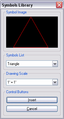

Hello All,
I have a simple code that creates blocks by selecting from a popup list and set it scale the same way before its inserted. The program then loops back to it main page for another selection. The problem is the selection always returns to the top of the list rather then remembering the last selection. I have tried with radio buttons, toggles, and edit boxes and have had success with those, But never could figure out how to do this with the popup list. I would appreciate any help with this that anyone can offer.
Thanks in advance and hope someone can shed some light on this.
The Buzzard

No change to DCL - changes marked in red.
Hope this helps :)
Lee

Thats great, But you did not use that in your own dcl piping code.
I did not think you would have responded to this thread, But I know that what you put out there is as good as gold.
I found these two if statements in the code, I guess thats all there is to it?
  (if SYM:DEF
   (set_tile "pl1" (itoa SYM:DEF)))
 (if DSF:DEF
   (Set_tile "ds1" (itoa DSF:DEF)))
Anyway thanks so much, Now I can get away from the radio button habit.
The Buzzard

Yeah, I probably should put that in my Piping Code - but its been so long since I have worked on the piping code, its so hard to navigate now :P
  (if SYM:DEF
 (if DSF:DEF
As for, is this all there is to it -
I have used SYM:DEF and DSF:DEF as global variables - (they are set when the user selects something - see action tile statement), but also note that I have had to change your atof to atoi as the position of the element in a list is denoted by an integer.
Hope this makes some sense :)
Lee

I did not notice that atof was replaced with atoi, Thanks for pointing that out. This will be a big space saver in the long run and mixing it with ASMI's list code gives it added benifits.
Got some fixes to do.
Thanks again
As always your best!
The Buzzard

I marked all the changes in red in the code I posted :P
Good luck with the fixes Buzz

Thanks Buzzard,
To be honest, I just experimented when you posted this thread, and worked it out from there - the set_tile only requires a key, and one other argument, so there was only really a small number of things that other argument could be :wink:
I'm glad this helps you out :D
Lee

haha - I barely have any caffeine actually o:)
Well, I knew you needed a global variable - that is the only way (well, the easiest) to "remember" things during a drawing session.
Then, I just experimented with the "set_tile", first I tried the actual strings, i.e.
(nth SYM:DEF sl_list)
then I tried integer positions (as strings - as "set_tile" only accepts strings):
(itoa SYM:DEF)
