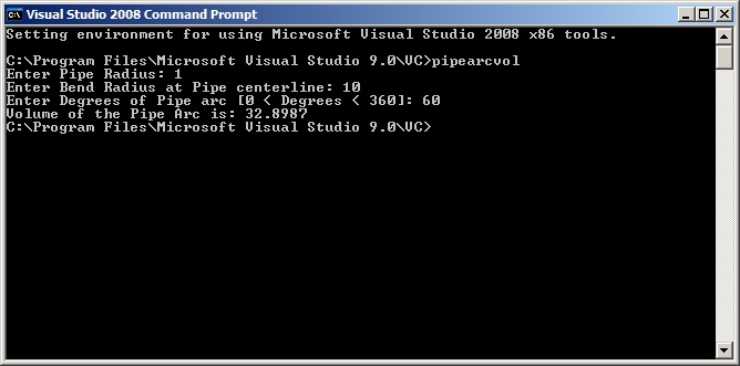

Initial Challenge:
Here’s a starter project that isn’t that far removed from “Hello World.”
Create a C++ Command Prompt program to calculate the volume of a Pipe Arc segment.
Input: Pipe radius, Pipe Arc Radius at Centerline, Angle of Arc in Degrees between 0 and 360.
Return: Volume of Pipe
My friend, nice but you forgot the pause at the end so people can read the area.
Also put a couple of notes on it
hope you dont mind
#include <iostream>
#include <cmath>
using namespace std;
int main()
// This declares them so they can be used.
// Aswell as that type of number it will be "double" = real "0.00"
double pi = 4.0 * atan(1.0);
double pipeRad;
double profileArea;
double bendRad;
double angInDegrees;
double angInRads;
double vol;
//count is similar to princ. cin is will save the input to that value
// similar to (setq piperade (getreal "\nEnter pipe radius :"
cout << "Enter Pipe Radius: ";
cin >> pipeRad;
// simple calc setting the thing to profile area
// similar to (setq profilearea (* (* piperad piperad) pi))
profileArea = pow(pipeRad, 2.0) * pi;
//Same as above
// (setq bendrad (getreal "\n Enter Bend radius at pipe centerline : ")
cout << "Enter Bend Radius at Pipe centerline: ";
cin >> bendRad;
// A simle if statement
// Notice you dont need progn
if (bendRad < pipeRad)
cout << "Inproper Bend Radius - Self intersecting Pipe!";
return 0;
//Same as above
// (setq angindegrees (getreal "\nEnter Degrees of Pipe arc [0 < Degrees < 360]: " : ")
cout << "Enter Degrees of Pipe arc [0 < Degrees < 360]: ";
cin >> angInDegrees;
// Normal if statement
if (angInDegrees < 0.0 || angInDegrees > 360.0)
cout << "Inproper Angle Value!";
return 0;
//simple calc same as above
angInRads = angInDegrees * pi / 180.0;
vol = angInRads * bendRad * profileArea;
//you can put mulitble things to the screan
// Simimlar to (princ (strcat "\nVolume of the pipe arc is :" vol ")) (princ)
cout << "Volume of the Pipe Arc is: "
[color=red]<< vol[/color]
[color=red]<< "\n";[/color]
// This pauses the console so things can be read
[color=red]system("PAUSE");[/color]
return 0;
Nice additional comments. That will help the Lisp to C++ transition.
With regard to the pause; I intended this as a command prompt app (i.e., not necessarily a VS console app) which stays fixed. Good heads up for those running this via the VS environment.
Ahh i see, Im useing dev-C++
So it makes it an exe to run..
