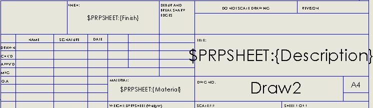

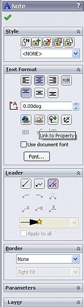

shift1313 Posted June 8, 2009 Share Posted June 8, 2009 Well if you open one of the standard title blocks you can edit it and save it as another name in the same directory so its there for you. When editing the title block you right click on it in the model tree and Edit Sheet Format. From there you will notice the text. You can select the text and edit properties. If you select link to property there are lots of standard properties you can link this to. There are places in the drawings for part numbers and thing like that which you can link. At the top left of the screen shot you can see there is a blank box. You can insert your company logo there as well or any other place after deleting or modifying whats in the box. I have played around with this a little but because its not required of me I have not spent a lot of time messing with it but I am sure the Help documentation will point you in the right direction. Quote Link to comment Share on other sites More sharing options...
shift1313 Posted June 8, 2009 Share Posted June 8, 2009 guess it would have helped if i attached the screen shots Quote Link to comment Share on other sites More sharing options...
