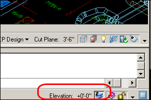

tzframpton Posted June 8, 2009 Share Posted June 8, 2009 Just wondering what exactly this does? I haven't been able to find documentation in the Help file about this Elevation tool.... Thanks. Quote Link to comment Share on other sites More sharing options...
NBC Posted June 8, 2009 Share Posted June 8, 2009 Stores the current elevation of new objects relative to the current UCS. Quote Link to comment Share on other sites More sharing options...
tzframpton Posted June 8, 2009 Author Share Posted June 8, 2009 Stores the current elevation of new objects relative to the current UCS. You mean when I bring in a new object, and this Elevation is preset and the button is turned on, it will place the object at this elevation? Because I tried that and it doesn't work. That's why I'm wondering exactly what this Elevation tool takes over.... Quote Link to comment Share on other sites More sharing options...

alanjt Posted June 8, 2009 Share Posted June 8, 2009 (getvar "osnapz") straight from sysvdlg: Controls whether object snaps are automatically projected onto a plane parallel to the XY plane of the current UCS at the current elevation. 0 Osnap uses the Z-value of the specified point 1 Osnap substitutes the Z-value of the specified point with the elevation (ELEV) set for the current UCS Quote Link to comment Share on other sites More sharing options...
tzframpton Posted June 9, 2009 Author Share Posted June 9, 2009 ohhhhhhhhhh gotcha. Thanks Alan!! Quote Link to comment Share on other sites More sharing options...
alanjt Posted June 9, 2009 Share Posted June 9, 2009 ohhhhhhhhhh gotcha. Thanks Alan!! no problem, i wondered what it was when i first moved to 09. Quote Link to comment Share on other sites More sharing options...
