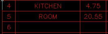

spasobn Posted June 10, 2009 Share Posted June 10, 2009 Please, I don't know how to split one cell into cell with 3 column. So, I need to transform cell below "ROOM" content to cell with three column as in Pic2 I use AutoCad 2008. Thanks Quote Link to comment Share on other sites More sharing options...
tzframpton Posted June 10, 2009 Share Posted June 10, 2009 Select the Kitchen table cell. Click the "Insert Column to Right" button twice, then merge and adjust the width back to where it was for the Kitchen & Room table cell. Quote Link to comment Share on other sites More sharing options...
spasobn Posted June 10, 2009 Author Share Posted June 10, 2009 Thank, it works but I hope it would be something just on one click. With "Insert Column to Right" with a lot of rows would be tired to merge all the rows and adjust column's width. Quote Link to comment Share on other sites More sharing options...
chelsea1307 Posted June 10, 2009 Share Posted June 10, 2009 you can select all rows/columns you need merged then select merge by row or merge by column and it will only merge in those ways, in your case i think you would want merge by row Quote Link to comment Share on other sites More sharing options...
spasobn Posted June 10, 2009 Author Share Posted June 10, 2009 Yes, you are absolutely right. Thanks for a quick reply. Quote Link to comment Share on other sites More sharing options...
