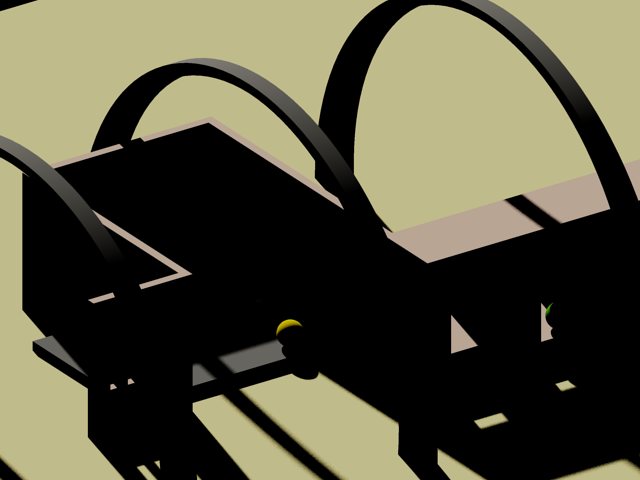

I followed Visualization: Basics of Rendering in AutoCAD 2009 from autodesk and when comparing my render to thiers mine is realy dark. I followed everything step by step, except on the manual performance tuneup. It says make sure Full Shadow Dispay is on, and I couldnt get mine to turn on. Is that why all my renders are dark or am i missing something else completely?

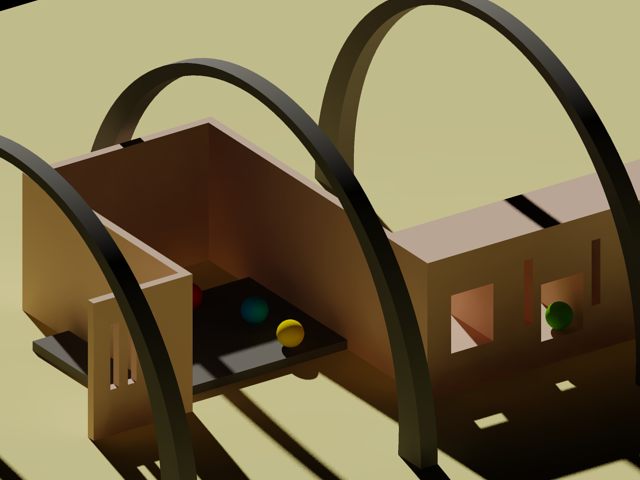

I guess what you got is on the first pic.
And the second one is with some changed settings.
what settings did you change? was my sun really facing the wrong way? i feel like a dork now!
the one i got was much darker then your first one, now it wants to crash my autocad if i can get it working ill post a screen shot of what it looks like

The sun is ok. You should turn Glonbal illumination ON, and Final Gather ON.
Try that and post what you get.
its about a million times better. did you change the material settings? mine doesnt look like yours

Do the following:
SUN - ON
SKY - sky background and illumination
Set the render to HIGH
GLobal illumination - ON, rays 500
Final Gather - ON, rays 100.
And render the image.
