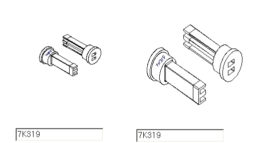

Does anyone have a suggestion for Embedding ISO views from AutoCad drawings into Microsoft Access Database.
Currently I have been using AutoCad LT. (Release 1_c1)
I select all of the lines and then select Edit: Copy: Embed from the Menu.
I then do a Control-V or Paste into the Access Database.
The Database table lists the pasted item as OLE object.
It works great, but I have a very old version of Autocad LT that I am using, and I would like to get rid of it. Sometimes it takes forever to load.
I do most Autocad work using Mechanical Desktop, And I am migrating towards Inventor.
The trouble is that when I use Copy link or Copy with Base point using AutoCad 2009, (Autodesk Mechanical Desktop 2009 SP2) the Picture comes out too small.
I can scale the original, and improve, but I can’t seem to get the same results that I get using the old AutoCad LT.
http://www.cadtutor.net/forum/attachment.php?attachmentid=12583&stc=1&d=1245098281
