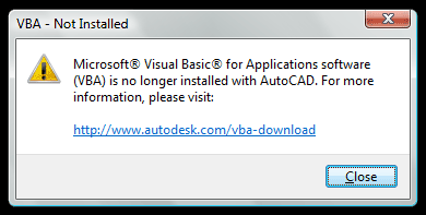

As I have found with 2010, VBA is no longer here...

Here is a question for you: Do you plan to download the necessary file to activate VBA on you 2010 setup?

I have considered learning VBA, as it doens't seem too far removed from LISP - as most of the methods used in LISP are VBA applicable, with just a different way of formatting the code. But now I am just thinking of focussing on C++, which would put me in my better standing to learn other languages.
So, in answer to your question, probably not.
I can’t say I’d blame you. . . . certainly not at this stage of the game. Actually, I wonder what percentage of AutoCAD 2010 users has taken the opportunity to download those files.
