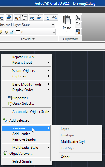

BlackBox Posted June 17, 2013 Posted June 17, 2013 (edited) Do you know of a block rename routine that will actually rename the block definition (the same way that RENAME does – but applied in the same manner as Lee Mac’s routine)? Perhaps this question deserves a new thread… FWIW - My Right Click Rename for AutoCAD® plug-in is under ADN review now, and will soon be published at Autodesk Exchange... Sample screen shot when a single Block is selected: Edited June 27, 2013 by BlackBox Updated link to live exchange app Quote

BlackBox Posted June 18, 2013 Posted June 18, 2013 Awesome, that looks like it will come in very handy, thanks BlackBox. That is kind of you to say, lamensterms... It has been very useful for me over the past several months, which is why I felt it was time to publish it... I hope others find it as useful as I have. Will there be a keyboard shortcut/command for users who have 'right click enter' and don't use the right-click menu? To clarify, this is not part of the standard right click menu (with, or without time sensitive right click); it's actually added to the context (right-click) menu, which is only displayed when one or more entities have been selected. I've coded this plug-in such that when one selects any single entity, the Rename context menu is enabled, and only the properties that apply to the selected entity populate the Rename context menu (i.e., a Block has a Block [name], whereas Mtext has a Text style, etc.), and only those property items that can be renamed are enabled, otherwise grayed out. As an example from this post, here are a few other entity types (i.e., Table, MLeader, Dimension, etc.): A planned enhancement already in the works, is a contextual Ribbon Tab, that will have a custom System Variable (or perhaps Options tab?) to control which configuration the user wants, so that the Rename tab will be added to the right of the user's Ribbon accordingly. In any event, thought this might help to clarify. As for the keyboard shortcut... That actually would not be that hard to implement, same command name for each 'style', and based on the applicable entity being selected (implied selection allowed, etc.), the same behavior would be enacted. I've also already thought of providing some LispFunction Method(s) to simplify the process within a user's custom code as well, rather than having to get a given TableRecord Object Name and EntMod, or access the parent Collection's Item, etc.. Cheers Quote

BlackBox Posted June 18, 2013 Posted June 18, 2013 (edited) That is a really cool tool, BlackBox. That means a great deal coming from you, RobDraw, and I appreciate that... Thank you. With all the bad CAD I have to deal with, I can see using it quite frequently. I've genuinely found this plug-in to be invaluable working on myriad client/consultant drawing standards since first developing it back during 2014 Beta. When will it be ready? As it happens, ADN has already completed preliminary testing of my plug-in. This morning (I'm at home today, on reduced hours), I received it back from ADN packaged in an installer, have already tested it, and requested that they publish my plug-in to Autodesk Exchange... I hope to hear back soon, and will be sure to share here when I do. #bbox Cheers Edited June 18, 2013 by BlackBox Quote
