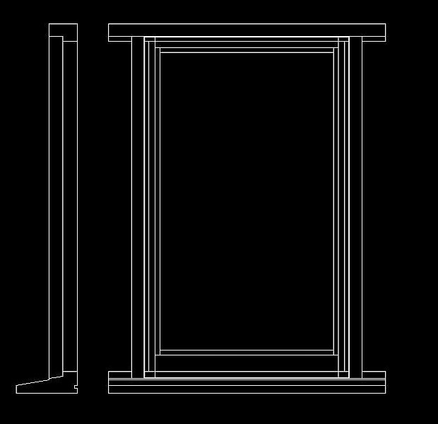

I am a bit happier with outcome.:) It's just the organising of all the Glazing bars variants do work on now.:lol:
Your coding is coming together Rob.
Nice work.
Delivered the in-laws back home so have been playing again:D.
This has moved on to be a complete single opening casement window with the start of a side elevation. Error routine was causing problems so took it out. Also found that to get over a "bad argument" error all I had to do was copy the first incidence of the variable and paste it in place!?
Word of warning! as I work in millimetres the program as it is contains dimensions pre-placed in mm's!

This is what it will produce. Have a few niggles to sort, like getting it to draw an arc for drip groove between c16 and c18 with c17 as centre point, not that I gave up or anything :unsure:
Rob-GB,
Great job with the default settings. The added side view is also a good add-in. The program ran fine with-out a hitch. Great Job!

(setq C2C (POLAR C2B (DTR 0.0) TEN)
(setq C3 (POLAR C1 (DTR 90.0) CTH)
(setq C4 (POLAR C3 (DTR 90.0) D3)
(setq C5 (POLAR C4 (DTR 90.0) JTH)  ; top corner head
(setq C6 (POLAR C5 (DTR 180.0) JWD)
(setq C7 (POLAR C6 (DTR 270.0) J1)
(setq C8 (POLAR C7 (DTR 0.0) J2)
(setq C9 (POLAR C8 (DTR 270.0) FRT)
(setq C10 (POLAR C9 (DTR 270.0) D3)
(setq C11 (POLAR C10 (DTR 270.0) FRT)
(setq C12 (POLAR C7 (DTR 270.0) D1)
(setq C13 (POLAR C12 (DTR 270.0) FIVE)
(setq C14 (POLAR C1 (DTR 180.0) CWT)
(setq C15 (POLAR C14 (DTR 90.0) CEG)
(setq C16 (POLAR C14 (DTR 0.0) TEN)
(setq C17 (POLAR C16 (DTR 0.0) SIX)
(setq C18 (POLAR C17 (DTR 0.0) SIX)
; plot points for frame
(setq F1 (POLAR IP (DTR 180.0) SEVENFIVE)  ; cill return from insert point
(setq F2 (POLAR F1 (DTR 90.0) CTH)
(setq F3 (POLAR F2 (DTR 0.0) SEVENFIVE)
(setq F4 (POLAR F3 (DTR 90.0) D3)
(setq F5 (POLAR F4 (DTR 180.0) SEVENFIVE)
(setq F6 (POLAR F5 (DTR 90.0) JTH)
(setq F7 (POLAR F6 (DTR 0.0) SEVENFIVE)
(setq F8 (POLAR F7 (DTR 0.0) WIDTH)
(setq F9 (POLAR F8 (DTR 0.0) SEVENFIVE)
(setq F10 (POLAR F9 (DTR 270.0) JTH)
(setq F11 (POLAR F10 (DTR 180.0) SEVENFIVE)
(setq F12 (POLAR F11 (DTR 270.0) D3)
(setq F13 (POLAR F12 (DTR 0.0) SEVENFIVE)
(setq F14 (POLAR F13 (DTR 270.0) CTH)  ;bottom right corner of frame
(setq F15 (POLAR F1 (DTR 90.0) CEG)             ; cill edge
(setq F16 (POLAR F14 (DTR 90.0) CEG)            ; cill edge
(setq F17 (POLAR F6 (DTR 270.0) J1)             ; head face
(setq F18 (POLAR F9 (DTR 270.0) J1)             ; head face
(setq F19 (POLAR C12 (DTR 0.0) J3)       ; cillstep
(setq F20 (POLAR C13 (DTR 0.0) J3)       ; cillstep
(setq F36 (POLAR F19 (DTR 0.0) W1)
(setq F37 (POLAR F20 (DTR 0.0) W1)
(setq F21 (POLAR F17 (DTR 0.0) SEVENFIVE)      ; jamb
(setq F22 (POLAR F19 (DTR 0.0) SEVENFIVE)      ; jamb
(setq F23 (POLAR F21 (DTR 0.0) J1)       ; jamb
(setq F24 (POLAR F22 (DTR 0.0) J1)       ; jamb
(setq F25 (POLAR F4 (DTR 0.0) JTH)       ; jamb
(setq F26 (POLAR F3 (DTR 0.0) JTH)       ; jamb
(setq F27 (POLAR F4 (DTR 0.0) J1)       ; jamb
(setq F28 (POLAR F3 (DTR 0.0) J1)       ; jamb
(setq F29 (POLAR F18 (DTR 180.0) SEVENFIVE)     ; jamb
(setq F30 (POLAR F36 (DTR 180.0) SEVENFIVE)     ; jamb
(setq F31 (POLAR F29 (DTR 180.0) J1)      ; jamb
(setq F32 (POLAR F30 (DTR 180.0) J1)  ; jamb
(setq F33 (POLAR F11 (DTR 180.0) JTH)      ; jamb
(setq F34 (POLAR F12 (DTR 180.0) JTH)      ; jamb
(setq F35 (POLAR F12 (DTR 180.0) J1)      ; jamb
(setq F38 (POLAR F11 (DTR 180.0) J1)      ; jamb
(setq F39 (POLAR F28 (DTR 270.0) FRT)      ; jamb
(setq F40 (POLAR F35 (DTR 270.0) FRT)      ; jamb
; mullion section
; plot points for sash
(setq P1A (POLAR F24 (DTR 90.0) TWO)
(setq P1B (POLAR P1A (DTR 0.0) TWO)
(setq P1 (POLAR P1B (DTR 90.0) S1)  ;insert point for sash in frame
(setq P2 (POLAR P1 (DTR 0.0) SG)
(setq P3 (POLAR P2 (DTR 0.0) GRT)
(setq P4 (POLAR P3 (DTR 0.0) RW1)
(setq P5 (POLAR P4 (DTR 0.0) GRT)
(setq P6 (POLAR P5 (DTR 0.0) SG)
(setq P7 (POLAR P6 (DTR 270.0) S1)
(setq P8 (POLAR P7 (DTR 180.0) SG)
(setq P9 (POLAR P8 (DTR 180.0) GRT)
(setq P10 (POLAR P9 (DTR 180.0) RW1)
(setq P11 (POLAR P10 (DTR 180.0) GRT)
(setq P12 (POLAR P11 (DTR 90.0) BRG)
(setq P13 (POLAR P12 (DTR 90.0) GL1)
(setq P14 (POLAR P13 (DTR 0.0) GL2)
(setq P15 (POLAR P14 (DTR 270.0) GL1)
(setq P16 (POLAR P10 (DTR 90.0) BORA)
(setq P17 (POLAR P10 (DTR 90.0) HH)
(setq P18 (POLAR P17 (DTR 0.0) RW1)
(setq P19 (POLAR P9 (DTR 90.0) BORA)
(setq P20 (POLAR P16 (DTR 270.0) GRT)
(setq P23 (POLAR P19 (DTR 270.0) GRT)
(setq P21 (POLAR P17 (DTR 90.0) GRT)
(setq P22 (POLAR P18 (DTR 90.0) GRT)
(setq BRI (POLAR C12 (DTR 90.0) TWO)  ; bottom rail sash
(setq BR1 (POLAR BRI (DTR 90.0) BORA)
(setq BR2 (POLAR BR1 (DTR 270.0) GRT)
(setq BR3 (POLAR BR1 (DTR 0.0) GB)
(setq BR4 (POLAR BR3 (DTR 270.0) GRT)
(setq BR5 (POLAR BR3 (DTR 0.0) MD)
(setq BR6 (POLAR BR5 (DTR 270.0) (- BORA SLOPE))
(setq TRI (POLAR C7 (DTR 270.0) TWO)  : top rail sash
(setq TR1 (POLAR TRI (DTR 270.0) HEAD)
(setq TR2 (POLAR TR1 (DTR 90.0) GRT)
(setq TR3 (POLAR TR1 (DTR 0.0) GB)
(setq TR4 (POLAR TR3 (DTR 90.0) GRT)
(setq TR5 (POLAR TR3 (DTR 0.0) MD)
(setq TR6 (POLAR TR5 (DTR 90.0) HEAD)
;plot frame elevation
(setvar "OSMODE" 0)
(command "_.PLINE" IP F1 F2 F3 ""
(command "_.PLINE" F4 F5 F6 F7 F8 F9 F10 F11 ""
(command "_.PLINE" F12 F13 F14 F1 ""
)   ; outside drawn
(command "_.PLINE" F17 F18 ""
(command "_.PLINE" F15 F16 ""
(command "_.PLINE" C1 C2C C2B C2A C2 C3 C4 C5 C6 C7 C8 C9 C4 ""
(command "_.PLINE" C9 C10 C3 ""
(command "_.PLINE" C10 C11 C12 C13 C15 C14 C16 ""
(command "_.PLINE" C18 C1 ""
(command "arc" "c" C17 C18 C16           ; drip groove
(command "_.PLINE" C7 C12 ""
(command "_.PLINE" F21 F22 ""
(command "_.PLINE" F23 F24 ""
(command "_.PLINE" F25 F26 ""
(command "_.PLINE" F29 F30 ""
(command "_.PLINE" F31 F32 ""
(command "_.PLINE" F33 F34 ""
(command "_.PLINE" F27 F38 ""
(command "_.PLINE" F28 F35 ""
(command "_.PLINE" F19 F36 ""
(command "_.PLINE" F20 F37 ""
(command "_.PLINE" P1B P1 P2 P3 P4 P5 P6 P7 P8 P9 P10 P11 P1B ""
); outside drawn
(command "_.PLINE" P2 P11 ""
(command "_.PLINE" P5 P8 ""
(command "_.PLINE" P13 P14 ""
(command "_.PLINE" P12 P15 ""
(command "_.PLINE" P16 P17 P18 P19 P16 ""
(command "_.PLINE" P17 P21 ""
(command "_.PLINE" P18 P22 ""
(command "_.PLINE" P16 P20 ""
(command "_.PLINE" P19 P23 ""
(command "_.PLINE" BRI BR2 BR4 BR3 BR5 BR6 BRI "" ; bottom sash elevation
(command "_.PLINE" TRI TR2 TR4 TR3 TR5 TR6 TRI "" ; top sash elevation
(setvar "OSMODE" OLDSNAP)
(setvar "BLIPMODE" OLDBLIP)
(setvar "HIGHLIGHT" OLDLIGHT)
);defun

Rob,
In this section of the code there are some things you are doing here that seem a bit of a waste.
You are converting a string to a real and passing it to a variable.
Why?
Just enter it as a real in the first place.
;set other dims
(setq TWO (atof "2")  ; entering numbers this way due to number of errors from straight numbers
(setq TEN (atof "10")
(setq FIVE (atof "5")
(setq SIX (atof "6")
(setq SEVENFIVE (atof "75")
(setq J1 (- JTH FRT)
(setq J4 (atof "100")
(setq OFF1 (atof "175")
(setq J3 (+ J4 JWD)
(setq J2 (+ STW TWO)    ; jamb rebate and clearance
(setq J5 (- CTH WB)
(setq J6 (atof "0.017555555") ;this is the rate of declination per mm per degree
(setq GB (+ GLASS GRT)  ;assumes glazing bead or putty is of equal width and height
(setq J7 (* CILLANG J6)
(setq SLOPE (* J7 J2)
(setq SLOPE2 (* (- CWT JWD) (* CILLANG J6))
(setq D1 (+ (- HEIGHT (+ CTH JTH))(* FRT 2) SLOPE)
(setq D2 (- WIDTH (* J1 2))
(setq D3 (- HEIGHT (+ CTH JTH))
(setq S1 (- D1 (atof "4"))   ; sash height
(setq HH (- S1 HEAD)
(setq W1 (+ WIDTH 150)
(setq S2 (- D2 (atof "4"))  ; sash width
(setq GL1 (- S1 (+ (- HEAD GRT) (- BORA GRT)))
(setq GL2 (- S2 (* 2 (- STILE GRT)))
(setq RW1 (- S2 (* 2 STILE))
(setq BRG (- BORA GRT)
(setq SG (- STILE GRT)
(setq CEG (- CTH (+ 5 SLOPE SLOPE2 FRT))
(setq MD (- STW GB)
; plot points for side elevation
(defun DTR (a) (* PI (/ a 180.0))  ;degrees to radians
(setq C1 (POLAR IP (DTR 180.0) OFF1)  ; side elevation from insert point
(setq C2 (POLAR C1 (DTR 90.0) WB)
(setq C2A (POLAR C2 (DTR 180.0) TEN)
(setq C2B (POLAR C2A (DTR 270.0) TEN)
Example:
Change this
(setq J2 (+ STW TWO))    ; jamb rebate and clearance
To this
(setq J2 (+ STW 2.0))    ; jamb rebate and clearance
And you don't need this
There is no point in doing this in the first place.
Do you get my point?
If those are constants, Then enter them in as reals.
You only need to pass it to a variable when a constant does not apply and need to supply your calculations with a random number.
